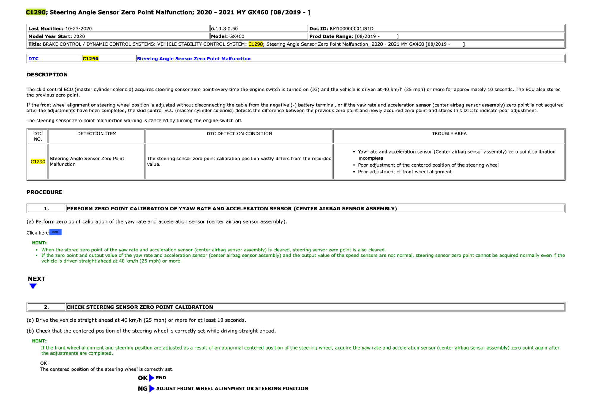

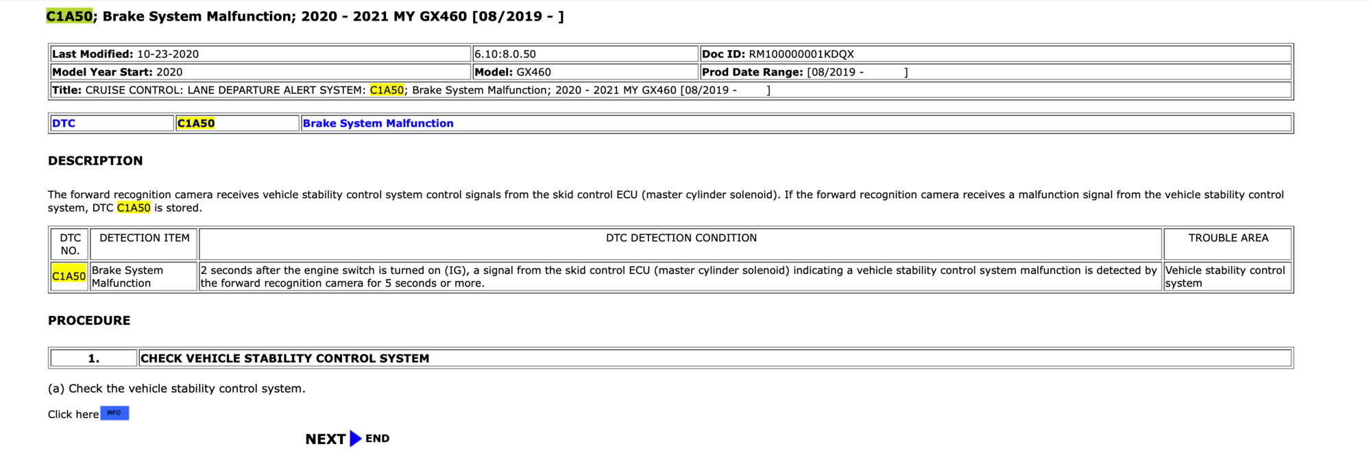

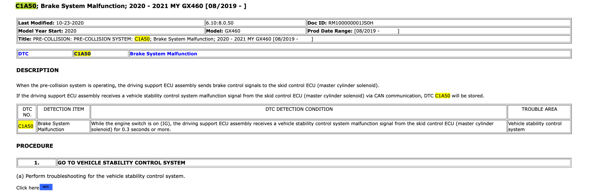

I was at the dealership again today and the codes were C1290 and C1A50.
