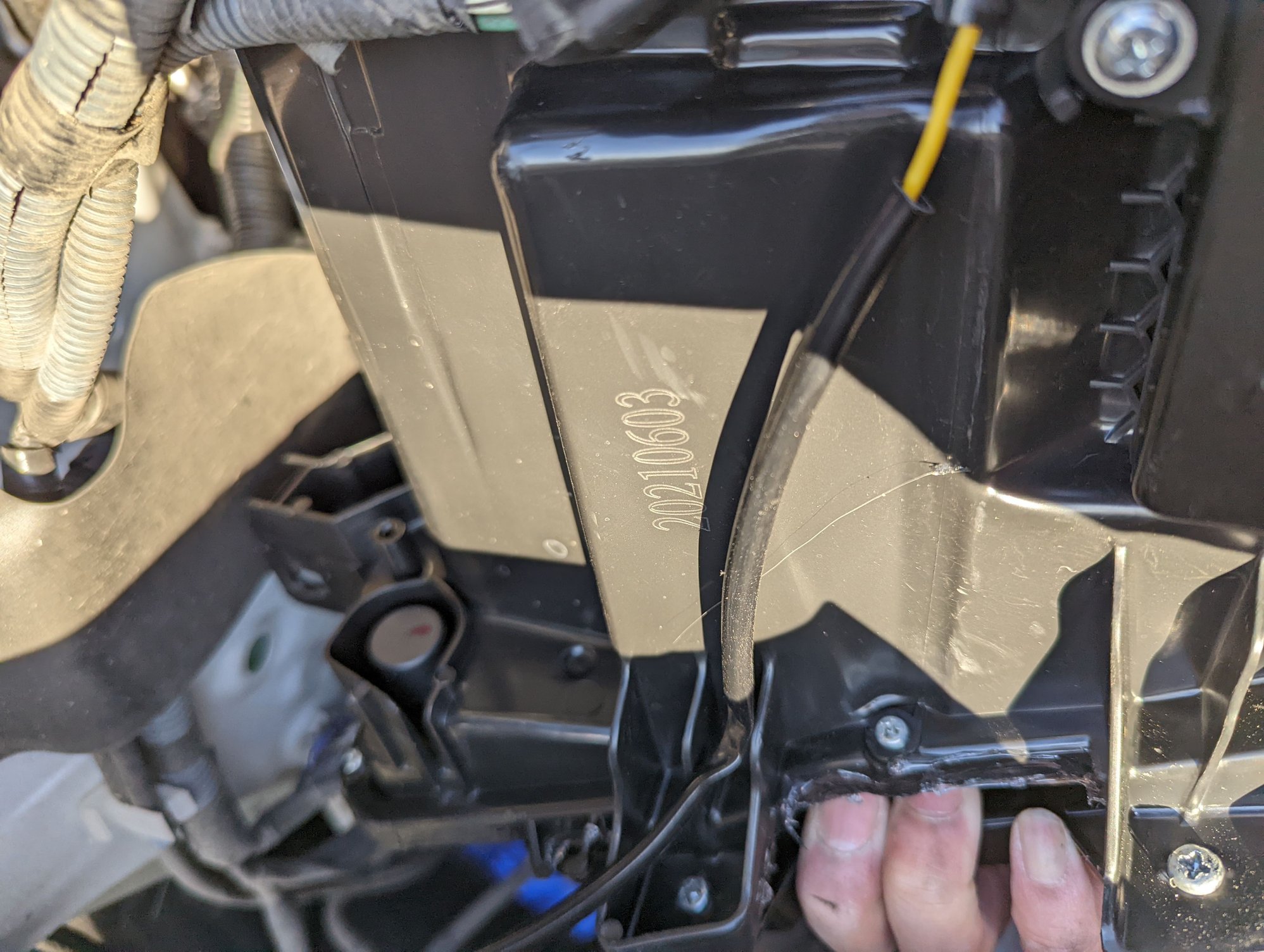

I added a few photos of the back of my headlights that stamped with a production date 12/12/2020.
Wiring harness comes out from a box located on the bottom of the headlight housings
Another view of the wiring
Beam adjuster
Production date
Close up on of the rear of the headlight
Birds eye view
No rubber caps

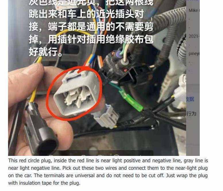

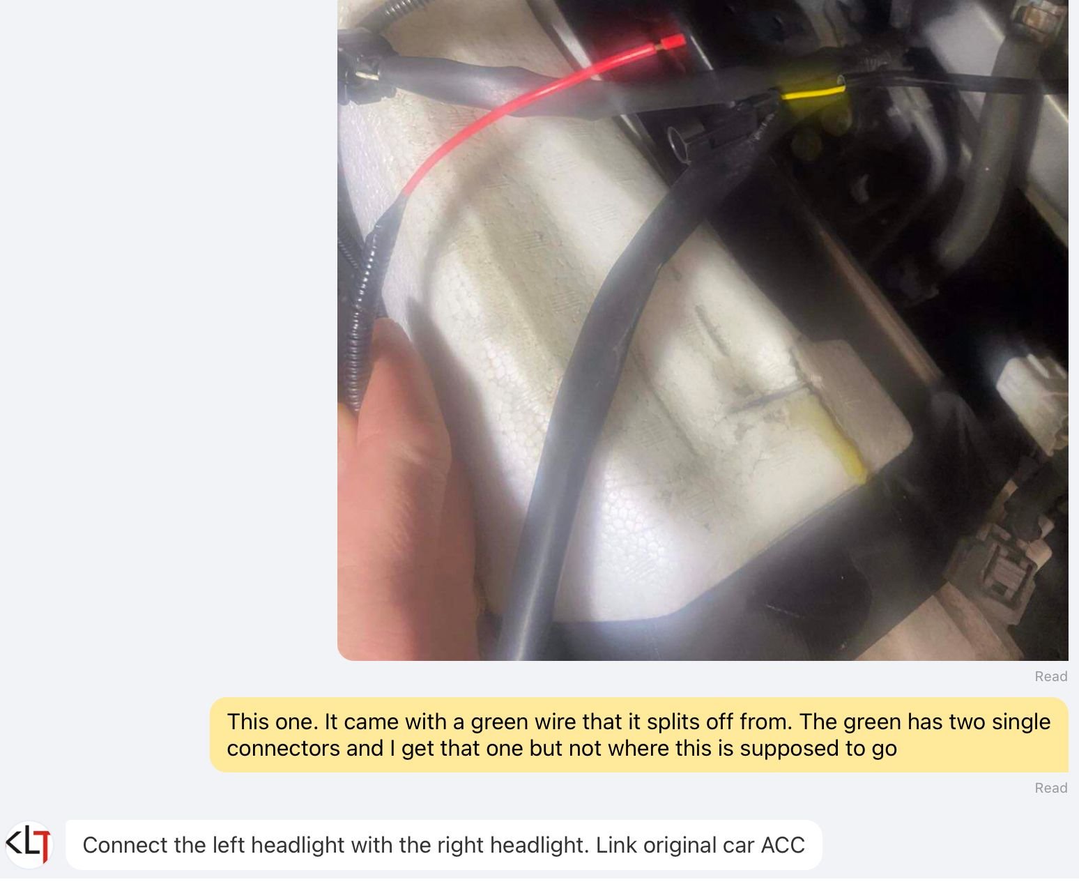

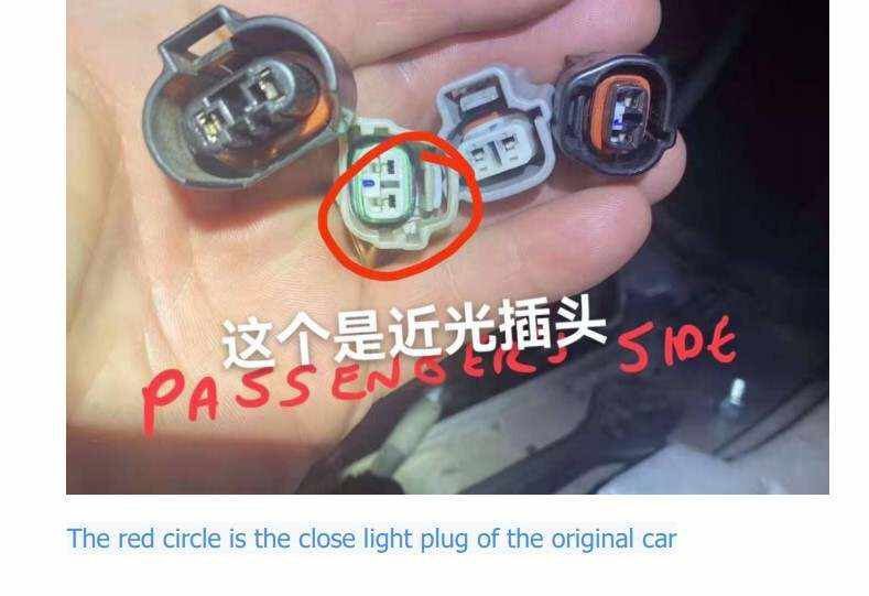

My 13 was a halogen model. From their wiring harness, I had to pull two of the wires out and put them into the factory receiver for the vehicle. This was for each side. Gifted is not a way to describe my electrical skills but, thankfully, their tech support person was very detailed and accommodating.
They asked me to send pictures of the plugs that my GX had, this was it.
They replied with these instructions.
And these.
These were the two that I pulled from the wiring harness and put them into this receiver. Secured them and everything worked, no error codes.
I created a thread to go over the basics of how the install went. In retrospect, I wish I had someone there to help with some of the work and that the parts came with instructions. Nonetheless, am very pleased with the outcome.

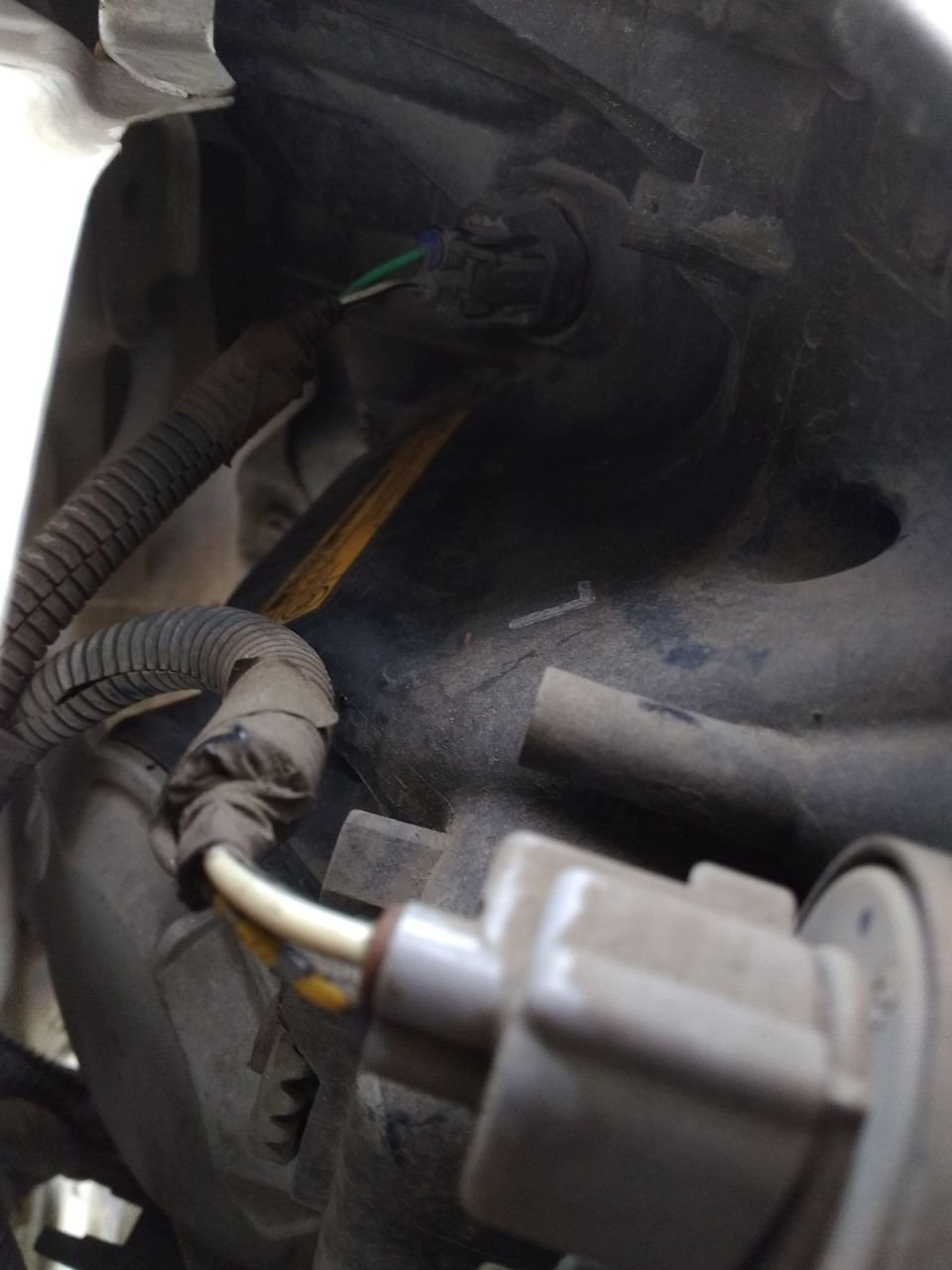

I bought my 2020+ headlamps from Alibaba - chenglong hu of Danyang Kailite Auto Parts Co. and my "check headlight system" will not go away. I have plugged in all the necessary plug and the new headlamp works great. I have a 2017 gx460 premium with driver assist package. Is there a way I can get rid of this error, I tried looking on this forum for a solution but I may of missed it.
Everything is connected, from headlamp to turning signal lamps - am I missing something?
Thank you in advance!

This tells me you bought the 2020+ headlight assembly made for the 2010-2013 conversion that’s why your getting the wrong resistance requirement for the 2014+ GX’s. Ask the seller for the decoder that’s supposed to come with it. Alpharex headlights come with the decoder already built into the headlights to prevent the error message. I have a video on this subject in YouTube.
