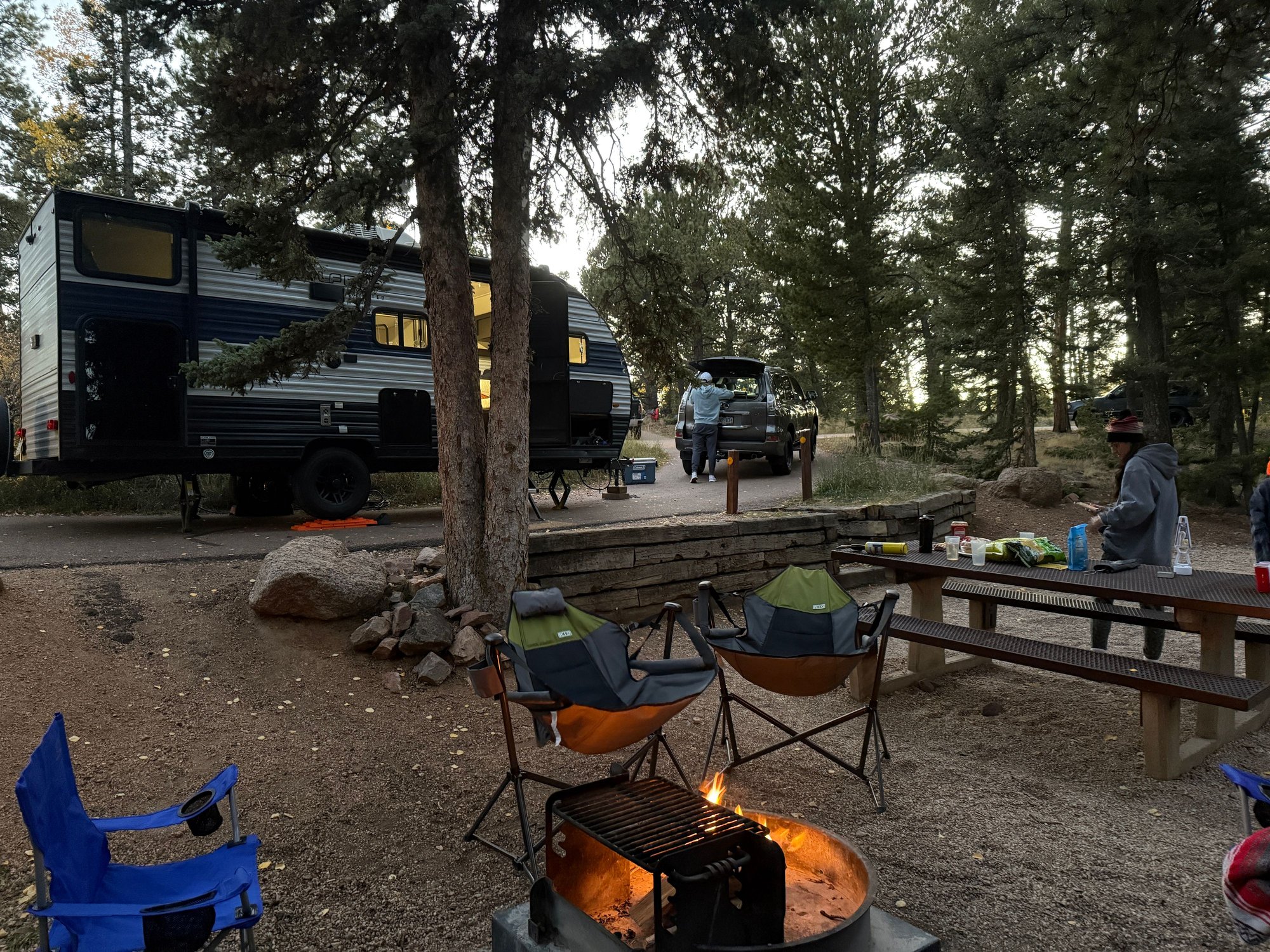

First time pulling an RV - about 4,000 lbs unloaded. The GX did well but I don't think I'd push the weight beyond that.

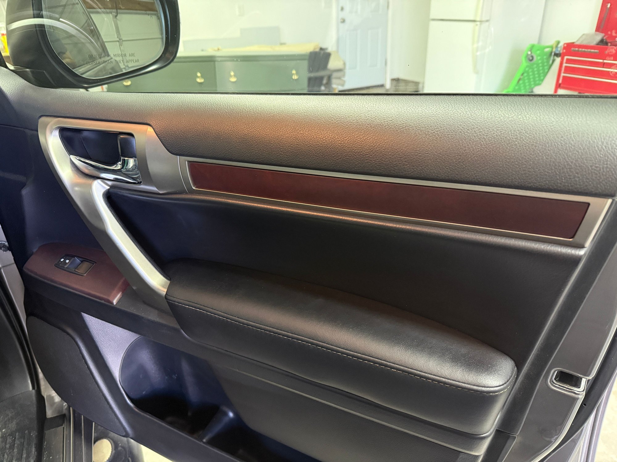

Decided to modernize the interior a bit by converting the "grandpa gloss" wood trip to a more modern matte. Surprisingly few documented guides on how to do this online, but I found a great starting point from someone who did this to their LX a while back (link). Basically, remove all the trim, sand with 220 grit, wipe with alcohol, and spray with multiple coats of Rustoleum Clear Matte Enamel spray. The hardest part of all of this was getting the door panels back on. Overall, I'm really happy with how this turned out!

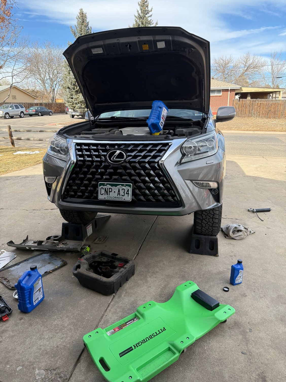

First up was some regular maintenance - oil and transmission fluid changes:
30k miles on this fluid, seems to be a pretty good interval for my usage:

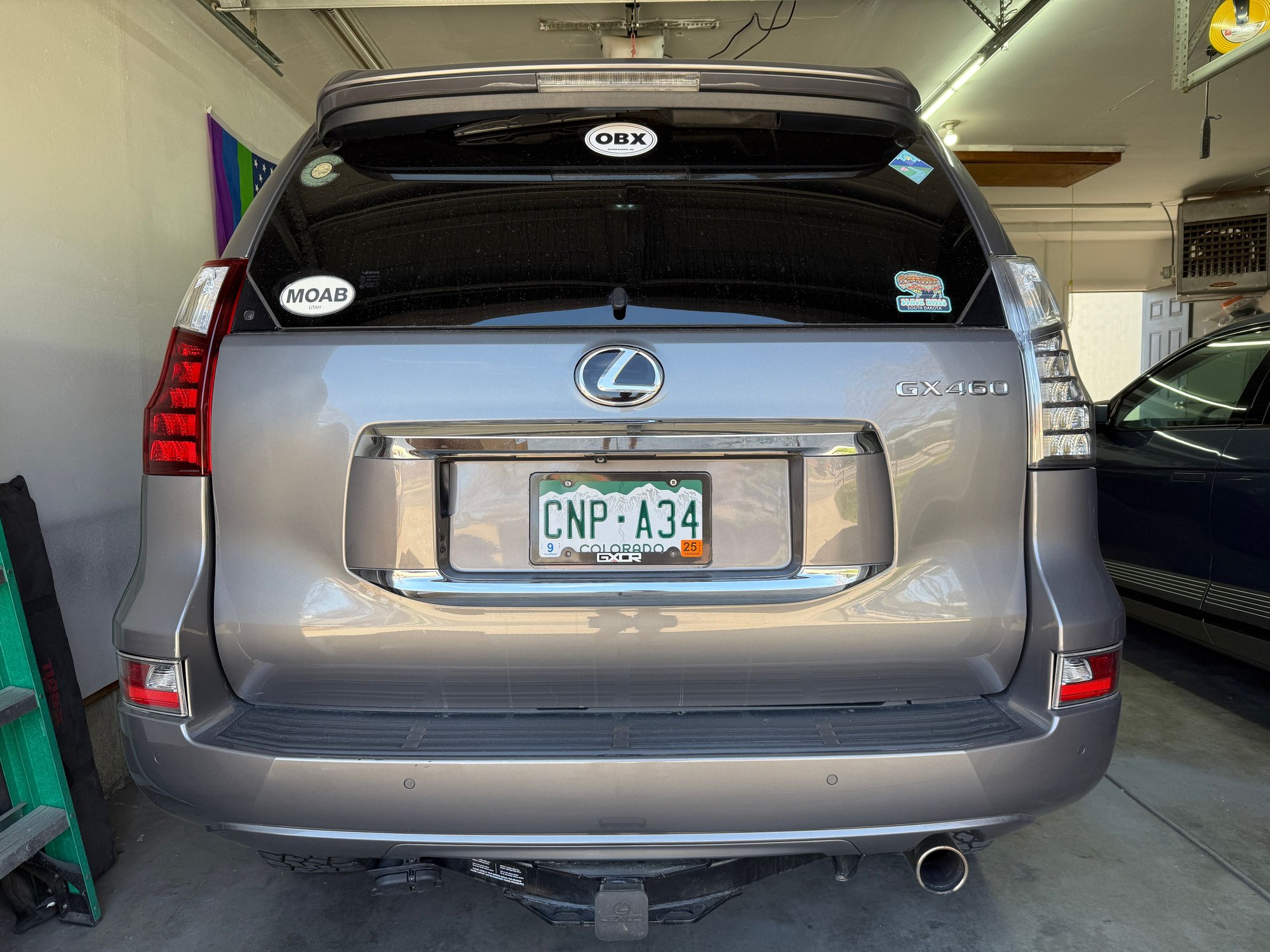

Topped it all off with Sport Design taillights - contrary to some posts here, they were plug and play with my 2014.
