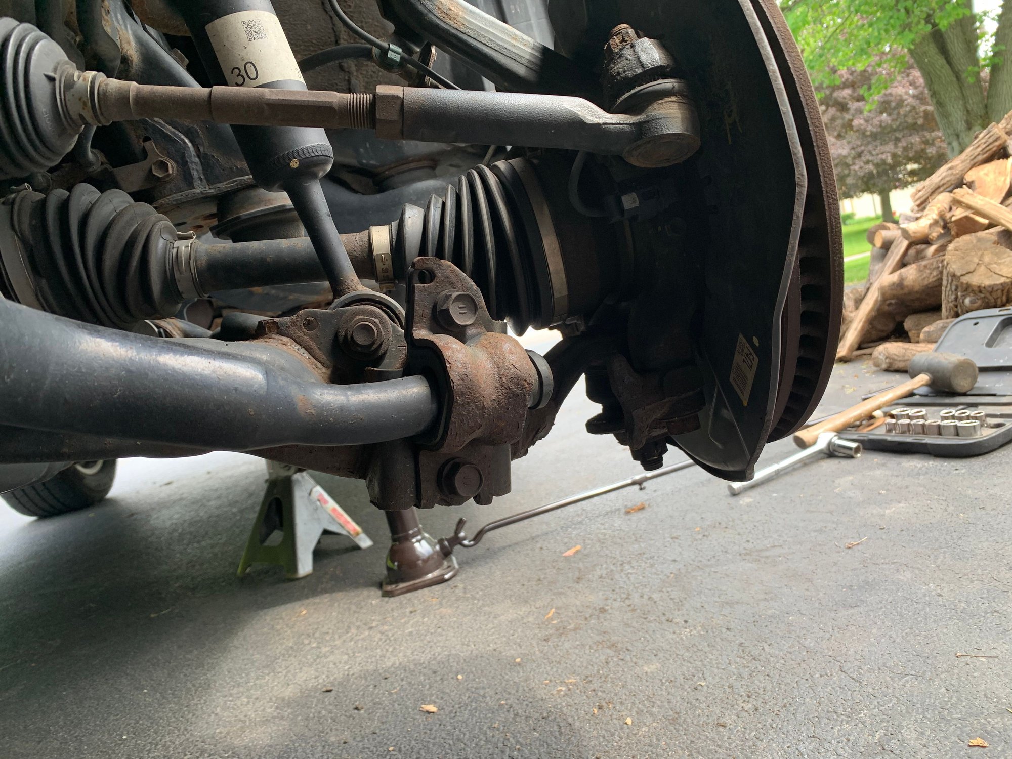

So, looking for some ideas….or confirmation on my plan. Was going to scrap all of this rust, which seems surface level, then put a coat protectant. I may to spot “painting” for now, then take to the dealer to have the entire underbelly done. Side note: the dealer has some sweet product ( not ziebart).
Honestly, I took the wheel off because I get a clicking sound on the front driver side wheel when I hit the brakes. Still can’t find the cause.
thoughts?
So sweet it doesn't have a name?
thoughts?
Fluid Film.

Curious as to why you are using the dealer? Premium price for everything like this and it is outsourced anyway.

I m in NJ and unfortunately our winters are tough on the vehicles undercarriage. I just bought a new to me GX and someone applied some goey oily stuff underneath to the frame rails. I plan on washing it off and my plan was to apply the Amsoil MP spray after watching LegitStreetCars on YouTube swear by the stuff. I look forward to seeing what you went with and how much you were quoted!

I did extensive research on rust prevention products, including by watching Project Farm.
First, absolute best product you need is one that contains cosmoline. It is a pretty harsh and waxy material but it is amazing for rust prevention. This is what submarines have been coated with to keep them from rusting in the sea. A great way to get a product with it is by getting the CRC Marine Heavy Duty Inhibitor. It sprays out of a can, it dries to a yellow but translucent waxy substance. It does not make a mess like fluid film. I love that it doesn’t have tint because I want to make sure I can see what it happening underneath. Try not to spray it on your exhaust or it will smoke a bit, but you can just put some aluminum foil over the exhaust while you spray. Check it out, this stuff is the best. Just wear a mask of course while spraying.

this is spot on. You can get it from Amazon and it’s about $13/can. Search for RP-342
