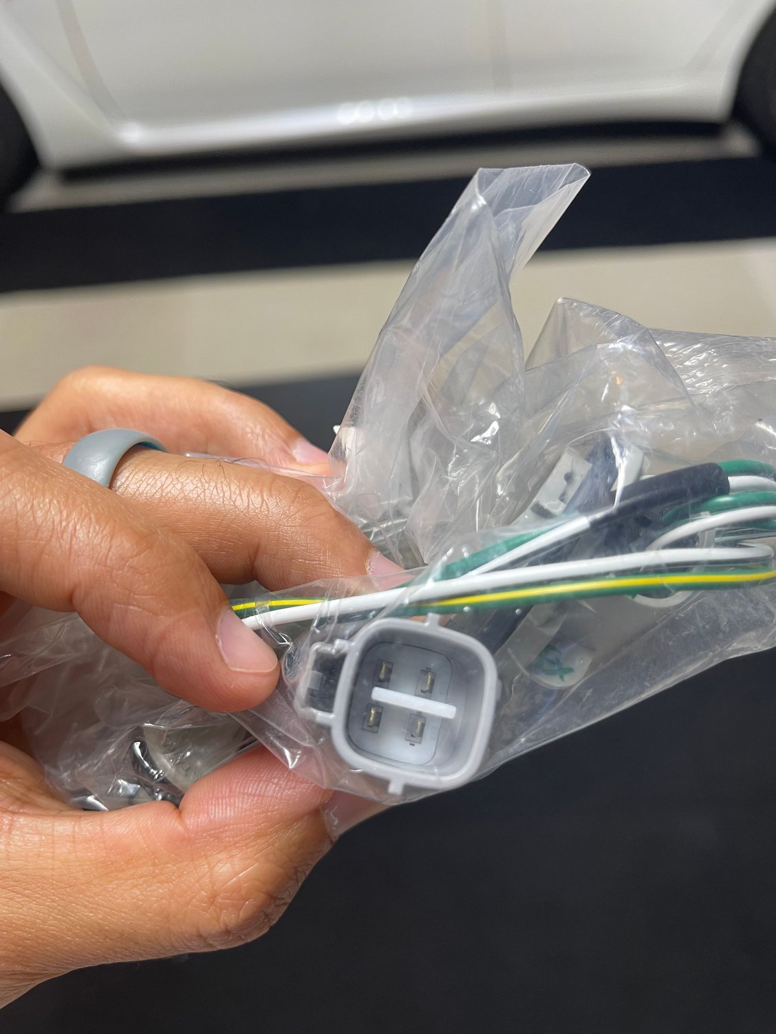

Any idea what's different between the two harnesses to know if they're necessary to order? I have a 2015 and assumed I would need the harnesses as well. Any chance of a side-by-side comparison or pics of the harness that is in your 2016?

hey vpj, this is what the harness looks like in my 2016. sorry its still in the bag, i am going to return them because its the same that i already had.
Thanks so much for the pic!
