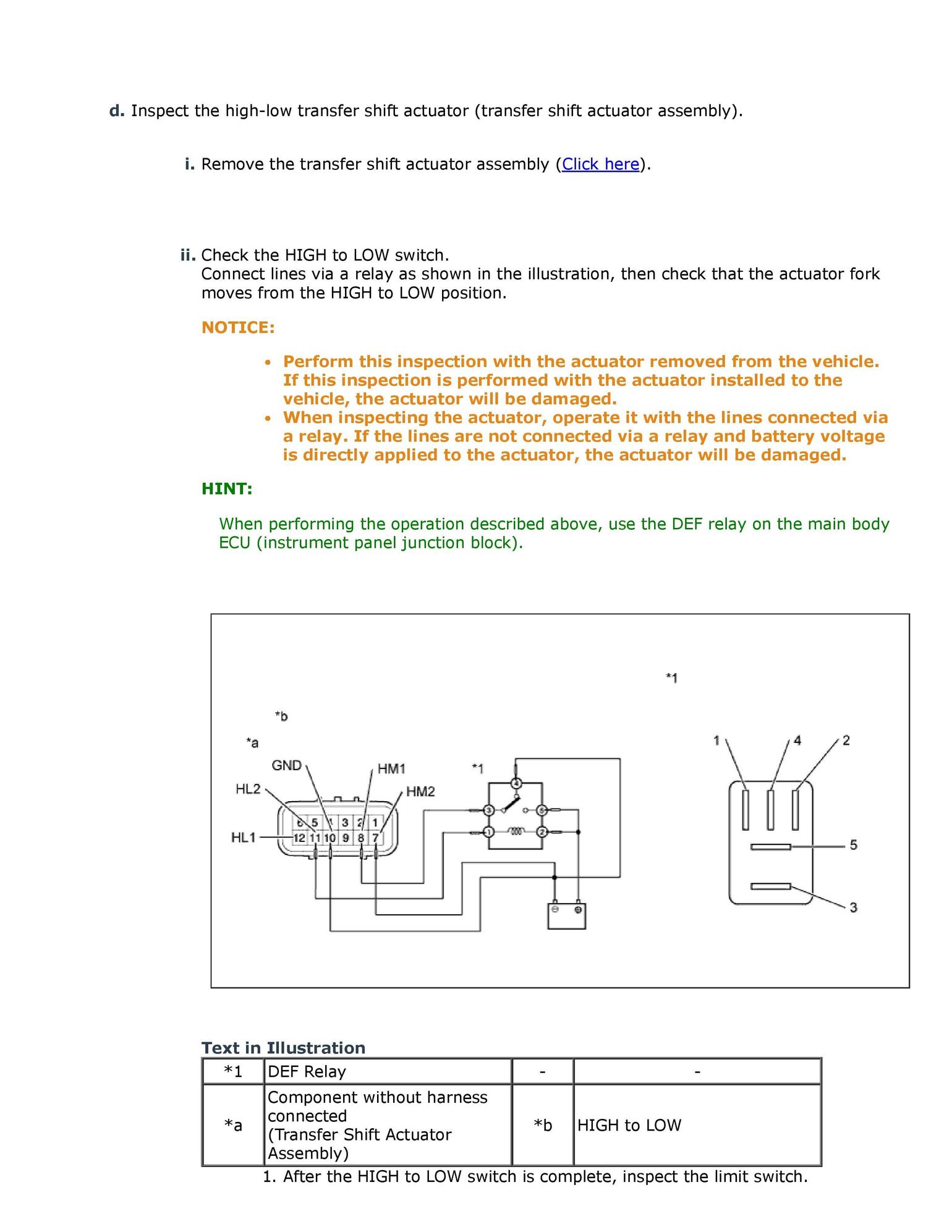

The 4WD ECU used by this area of vehicle requires multimeter for troubleshooting. You cannot simply pull codes.
