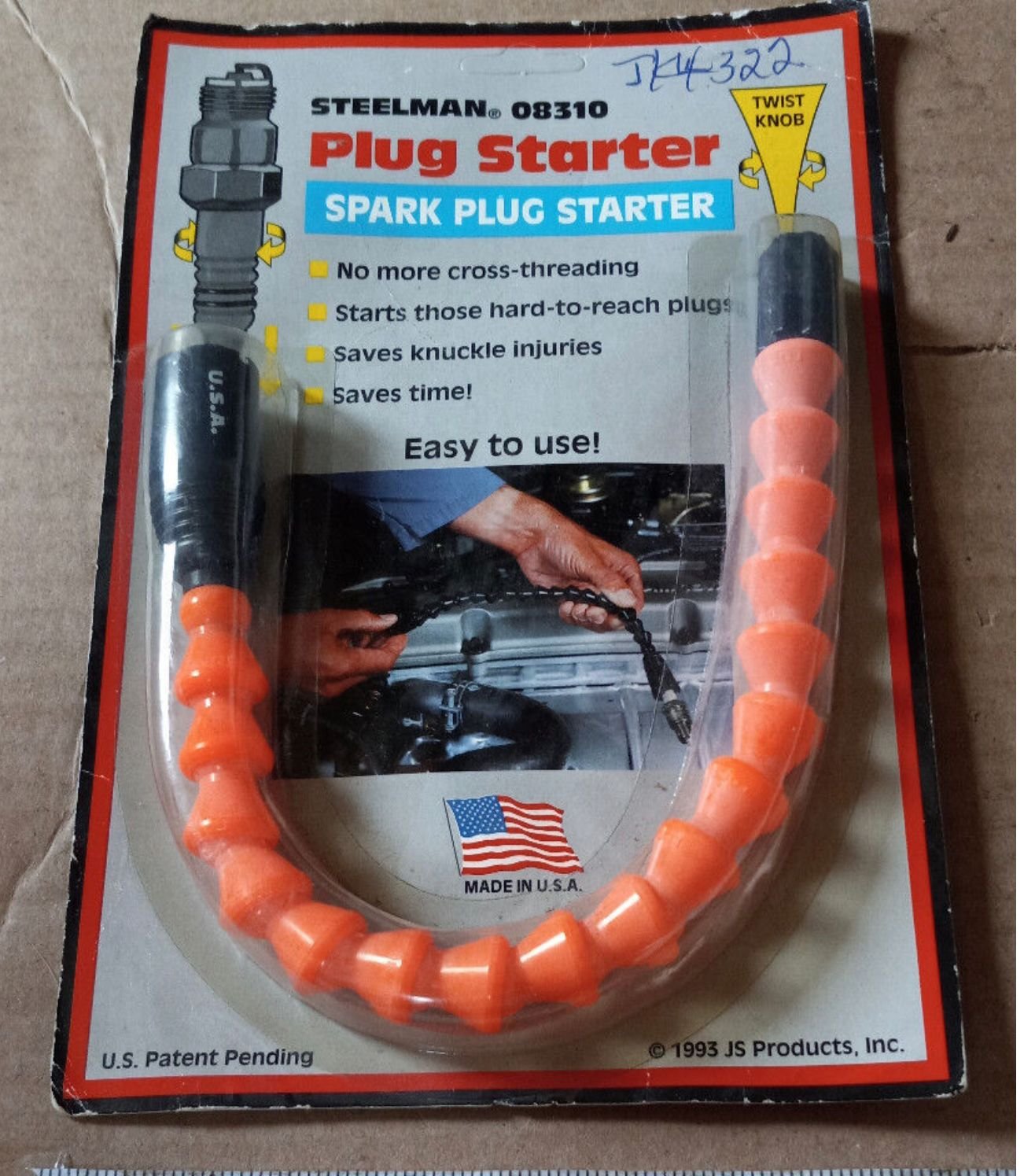

I used this tool as well… I have a paranoia about cross threading :-)

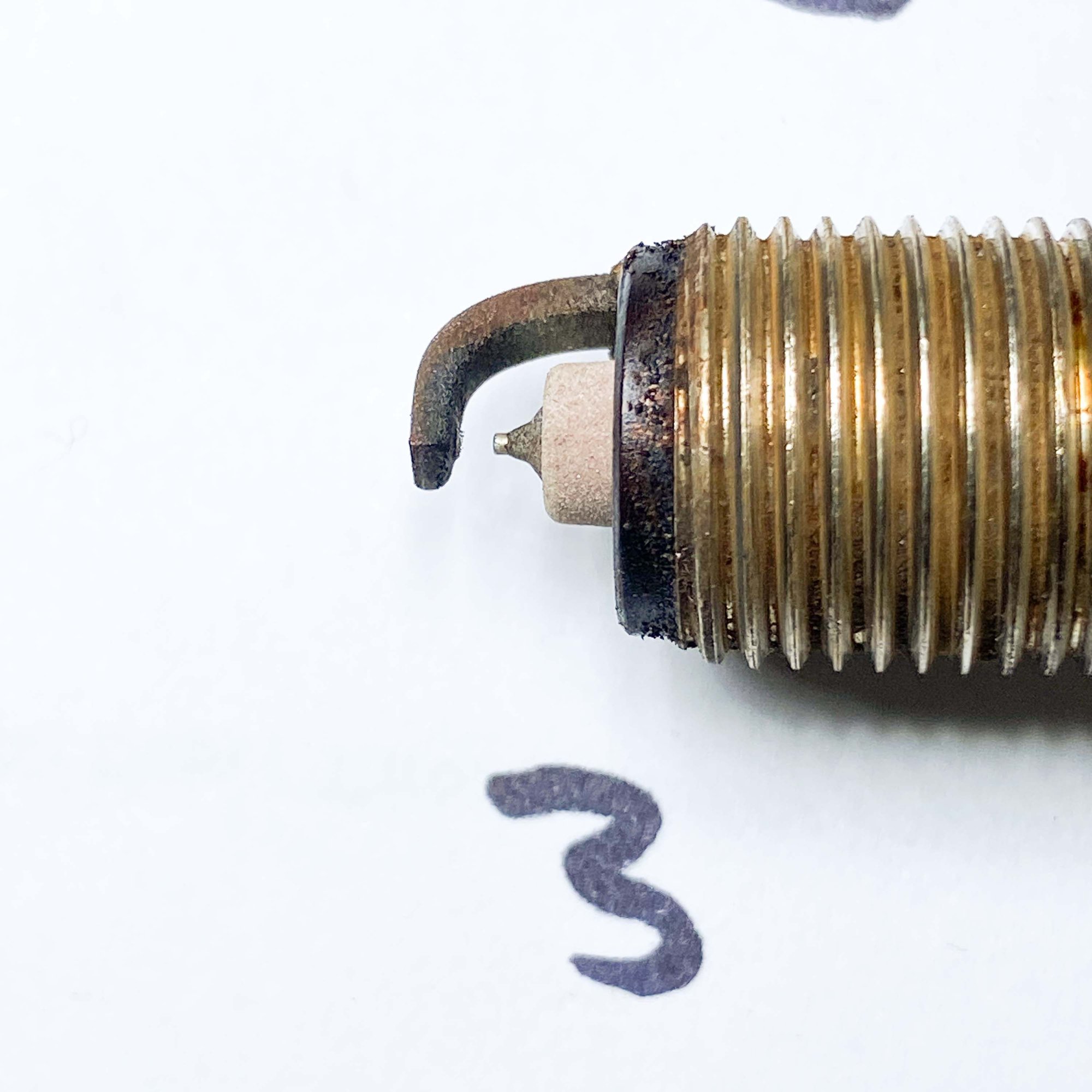

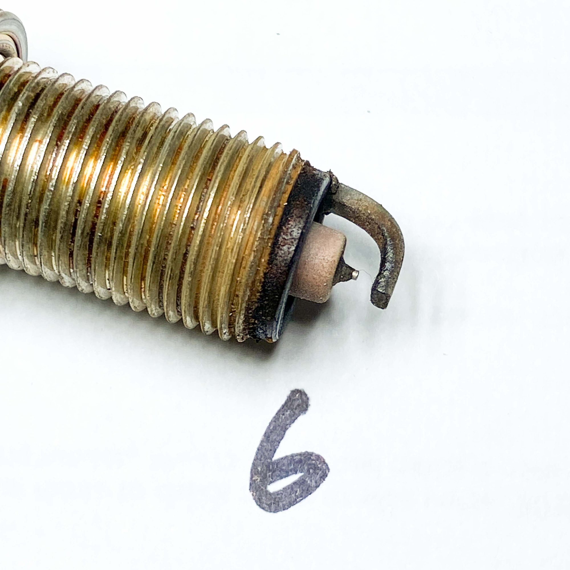

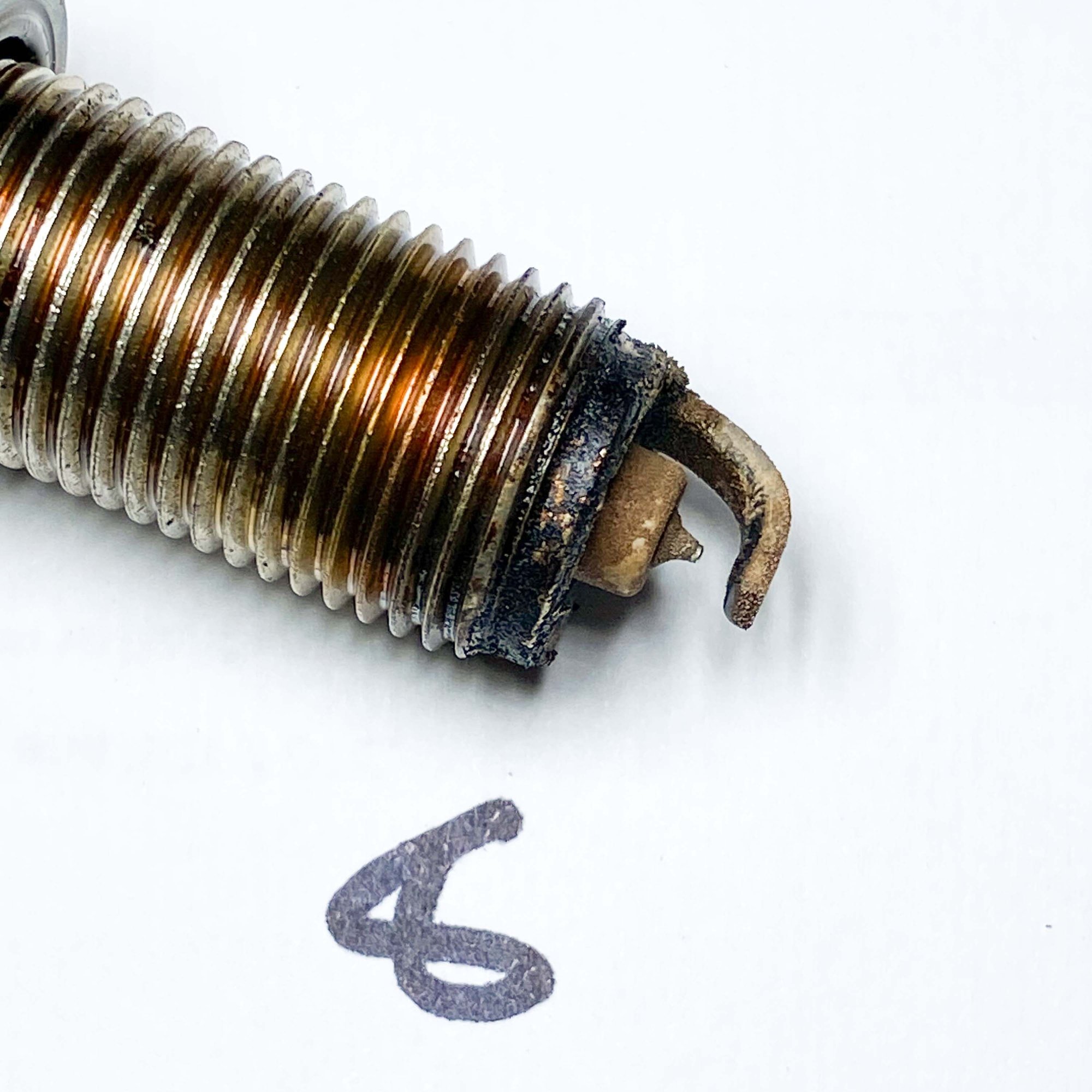

Question How do my spark plugs look?
2015 GX with 117,000 miles. These are the original plugs. Only #7 felt a little sticky with dried oil.
What are your thoughts?

They look fine. Check #7 tube for signs of oil leaking.

I replaced them all. I just wanted to know what others thought of how they looked and if there was anything I should be wary of.
I agree, I think 7 is leaking oil, and maybe 8 too.
This could be resolved by replacing the valve cover gaskets and the sparkplug gaskets, too, right?

Those look great for a 2015 with 117,000 miles.
