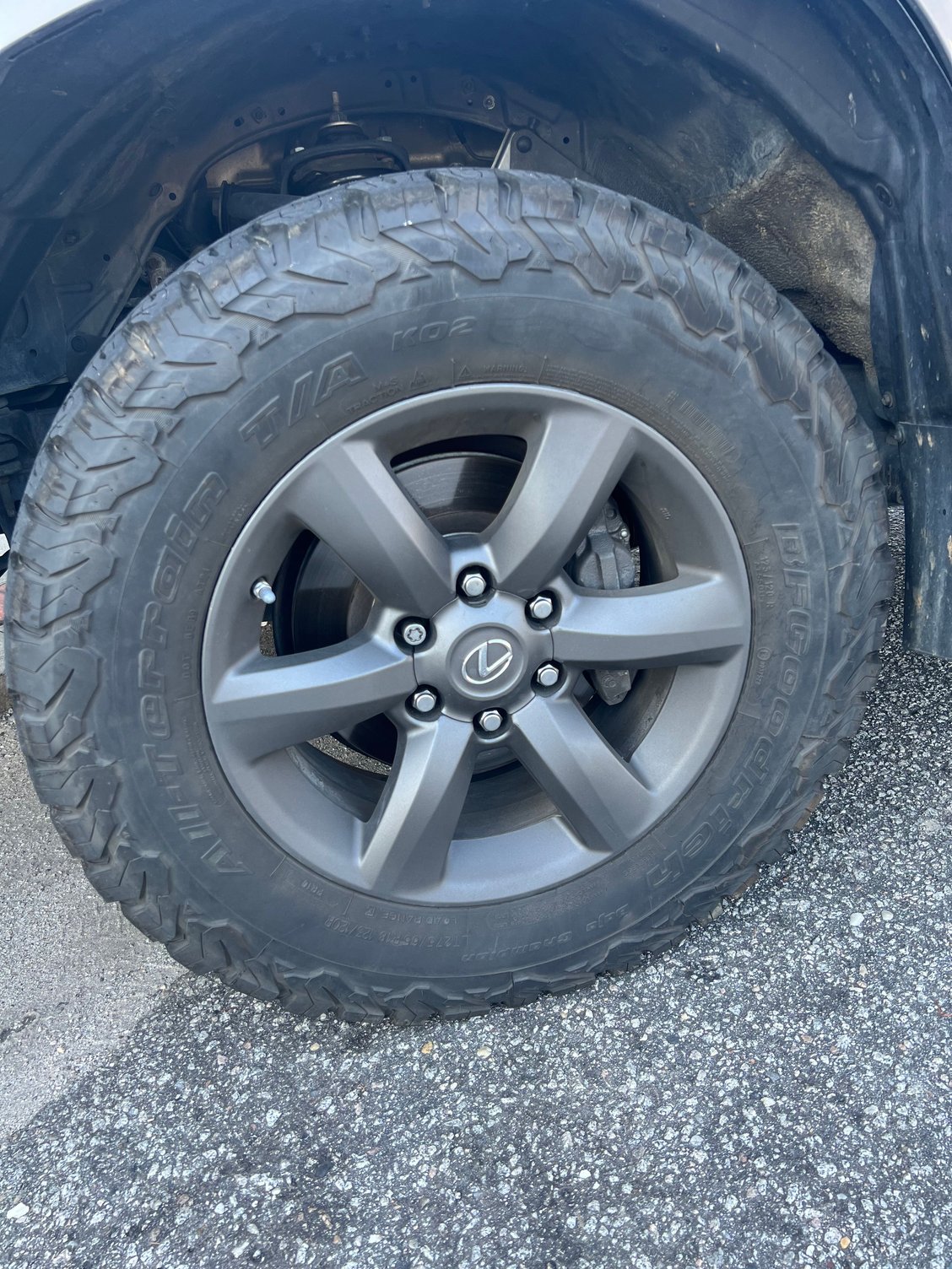

I ended up going the utilitarian route and am super happy with the results. The Goodyear's aren't the best riding tires, but it goes anywhere in any condition and still handles quite well now that I have sorted the tire pressure, at least 41 PSI for road.
No lift yet, pulled back front and rear of front wheel well liner with zip ties 3 months ago, it gets occasionally light rub at about half lock when accelerating or deccelerating.
2015 GX460 / No lift / 33x10.5R17 Goodyear Wrangler MT/R
Old May 30, 2022 | 01:19 PM
  #1447
ellocovg's Avatar
ellocovg
Joined: Oct 2009
Posts: 739
Likes: 207
Originally Posted by JustinFro
265/65r18 Falken Rubitrek A/T on stock suspension. No rub!
wow that’s an awesome look!
