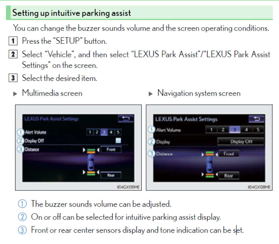

My parking sensors are randomly not showing up on the center screen. They do show on the Guage cluster and the beeper works. Is this common and what is the fix. It's a 2016 with 65k miles.

Do you have an OEM navigation or aftermarket?

OEM navigation

Check this menu in your setup,
