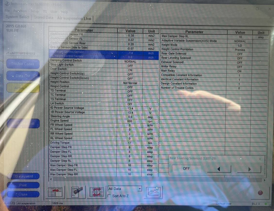

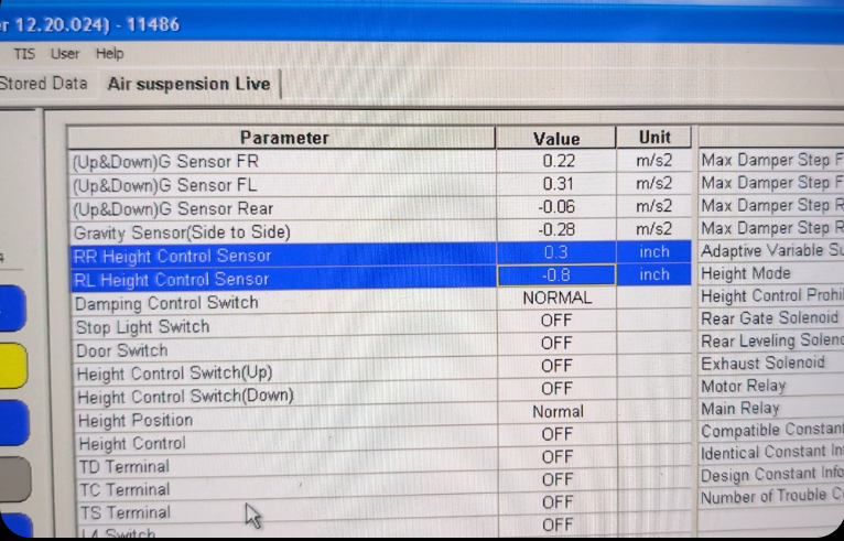

Old Feb 20, 2026 | 01:14 PM
guzzy92fs's Avatar
guzzy92fs
Joined: Aug 2012
Posts: 507
Likes: 166
From: Santo Domingo
As a follow-up to this fix, I want to clarify that there are two sensors at the rear (RH and LH). Initially, I only cleaned and lubed the passenger side (RH), but I eventually located the one on the driver’s side (LH) tucked behind the gas tank.
After plugging in techstream, I noticed a significant discrepancy between the two sides. This height difference is what makes the rear suspension feel so harsh; the ECU tries to compensate for the "lean" by over-inflating one of the airbags, leaving it with close to zero travel.
Initial Sensor Values:
  • Rear RH Sensor: 0.1 inches
  • Rear LH Sensor: -0.7 inches
  • Total Variance: 0.8 inches (This caused the "stiff" feeling over bumps)
I performed a manual adjustment. I loosened the 10mm nut on the LH sensor bracket and moved it while monitoring the live data until I got both sides as close to zero as possible.
Final Values:
  • Rear RH: 0.0 inches
  • Rear LH: -0.1 inches
I took the GX for a test drive over several speed bumps and the rear feels much plusher and the harsh "thud" is gone. If your GX feels like a tank in the back, check your sensor balance
I couldnt take a photo of techstream with final values but here is a pic of how it was moving while adjusting:
