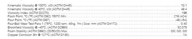

Motor oil and gear oil viscosities aren't rated on the same scale.
5W-30 Synchromesh:
75W-85 and 75W-90 gear oil:
Old Feb 16, 2026 | 09:15 AM
Yes they are, from your own data the test methods are ASTM D445 and ASTM D2983. Obviously 5w-30 is thinner viscosity compared to 75w which does not answer the question why thinner oil would "reduce clunk".
