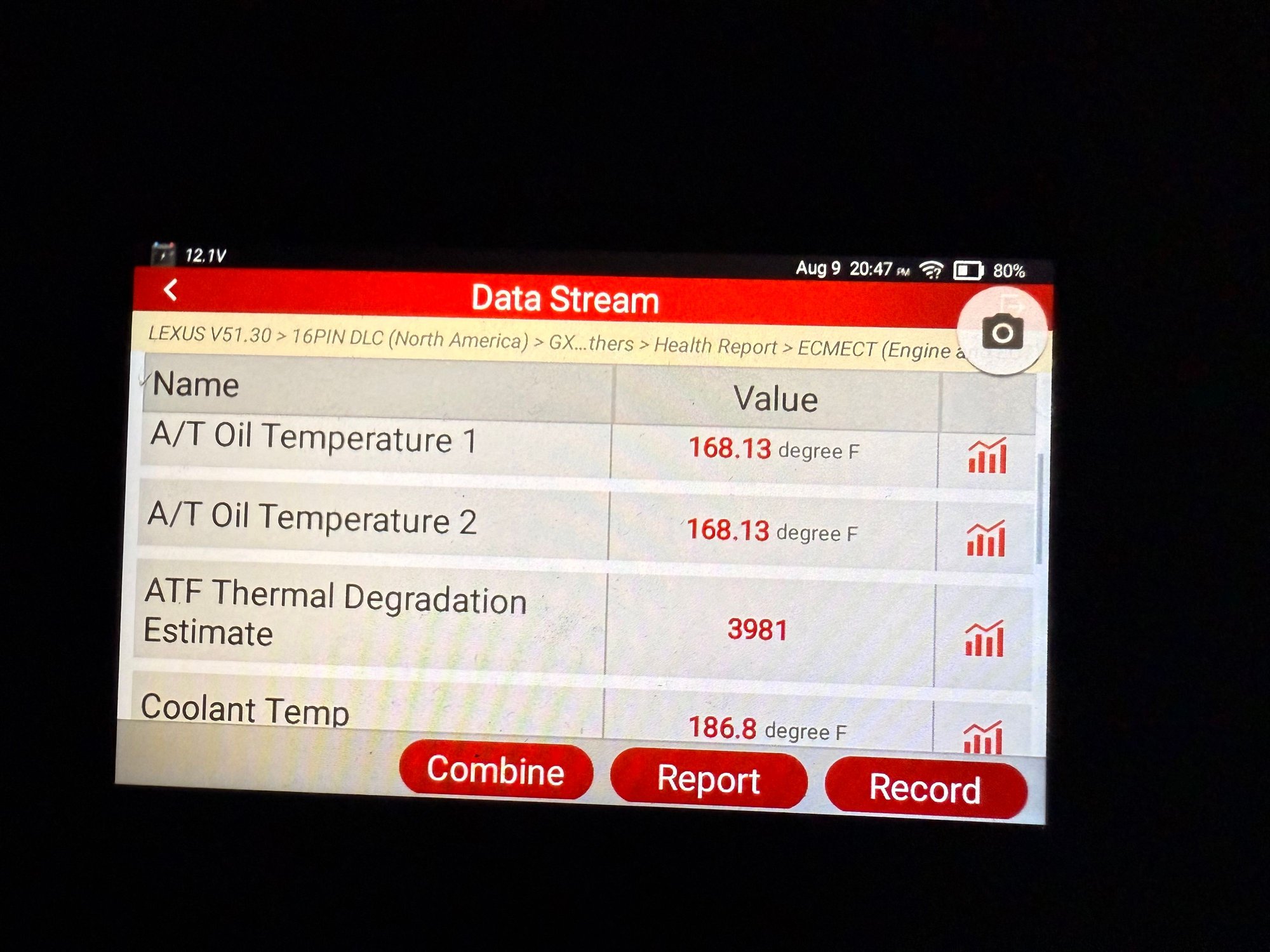

Fluid type: 8.5 quarts Aisin ATF-0WS mixed with OEM WS
Regular service: Yes
Aux cooler: Hayden 678
Rad: OEM
Eco light/tc lockout status: On
Transmission Temp: 168
Transmission thermostat: pinned open
Coolant Temp: 187 F
Ambient temp: ~90 deg F
Altitude: Near seal level
Duty: 80 mph interstate, fully stabilized temps after an hour of so of driving
With transmission thermostat unpinned transmission temps stay in the low 190s in the same conditions, so the transmission must have a ~190 degree thermostat
