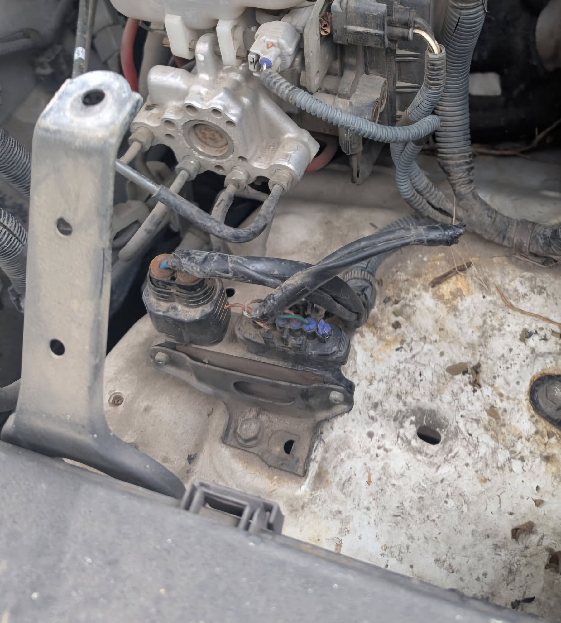

Damn rats or something chewed through the wiring and I need to replace this connector. Does anyone know what the connector is? Or do I need to worry about this if I go with the Hewitt delete kit? Thanks!
SAIS wire behind the fuse box

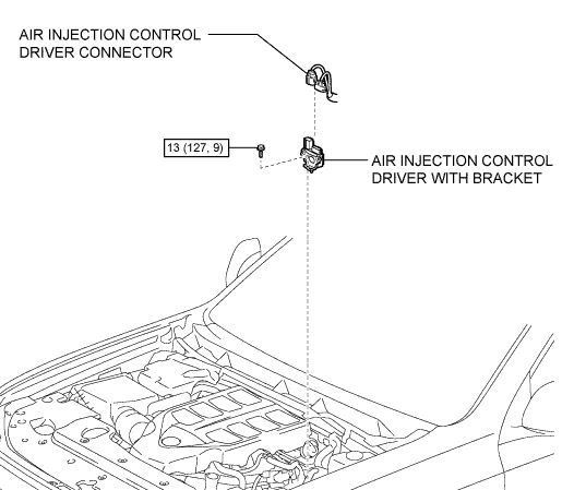

does anyone know what the connector is?
See pic below. I would image you will get a CEL with this damage.

yes. Got a p1613 code. Driver of secondary air injector fail. 4lo light on. Check engine light on. Traction control light on.

Does anyone know the type of 6 pin connector it uses?
For reference, here is the Toyota connector guide.
