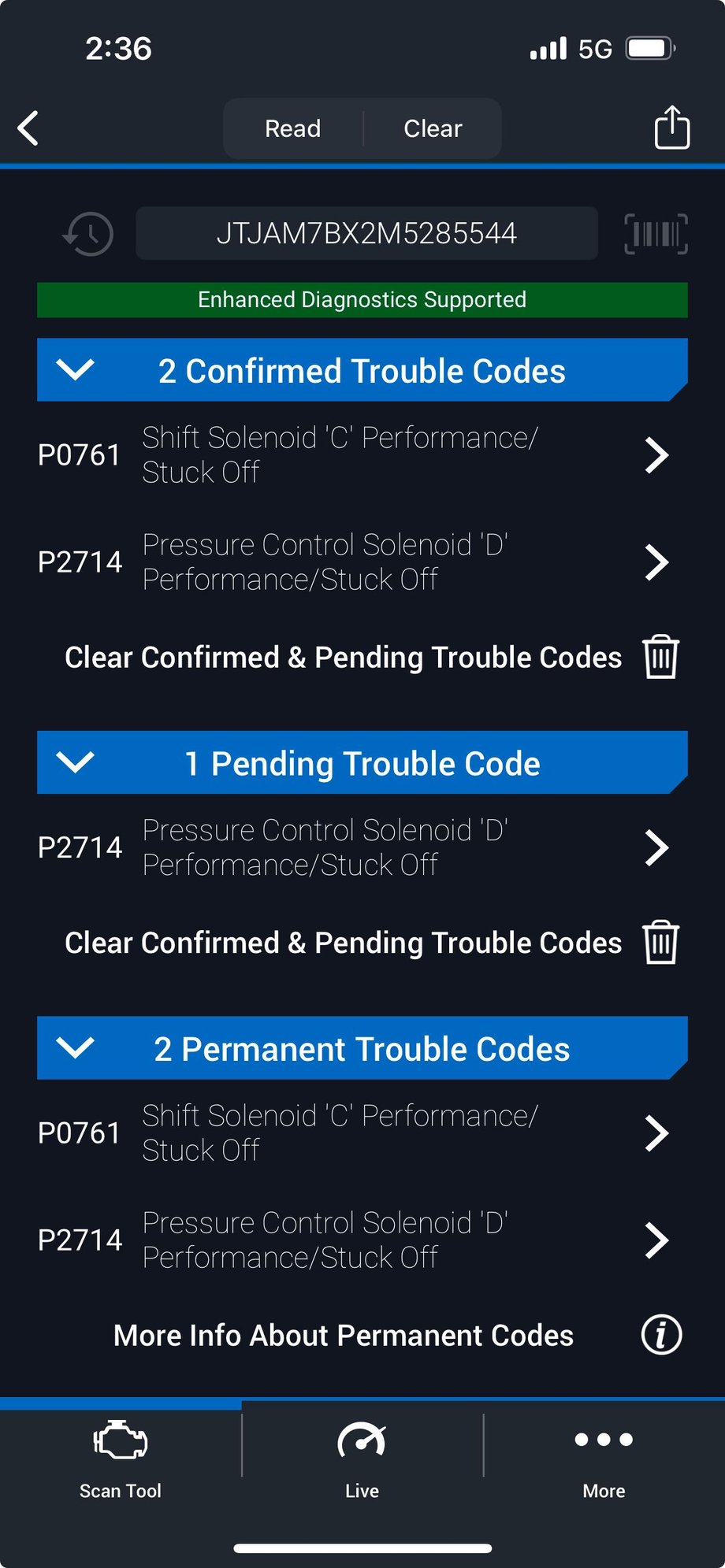

Unhappy 2021 GX Transmission issues
I purchased a 2021 Lexus GX 460 with only 27,000 miles on it. It had a hard shift around 60 mph that was determined to be a transmission selenoid. It was replaced and returned to me. About two weeks later I was driving and check engine light came on and trac off light. Took it back and it now had two transmission codes and one was still the original code which was a permanent code. They are now replacing the whole transmission luckily still under warranty. Does anyone have any issues like this? It seems crazy to get a new transmission after only 27K miles on a car and will that even solve the problem?

These were the codes I got the second time. The permanent code was the first time. They did take it apart replace the solenoid and I drove it. Then the check engine came on again and got both these codes. They tried to replace the solenoid’s again but got an error code still. So now new transmission but it’s on back order. Have no idea when I get my car bacj
