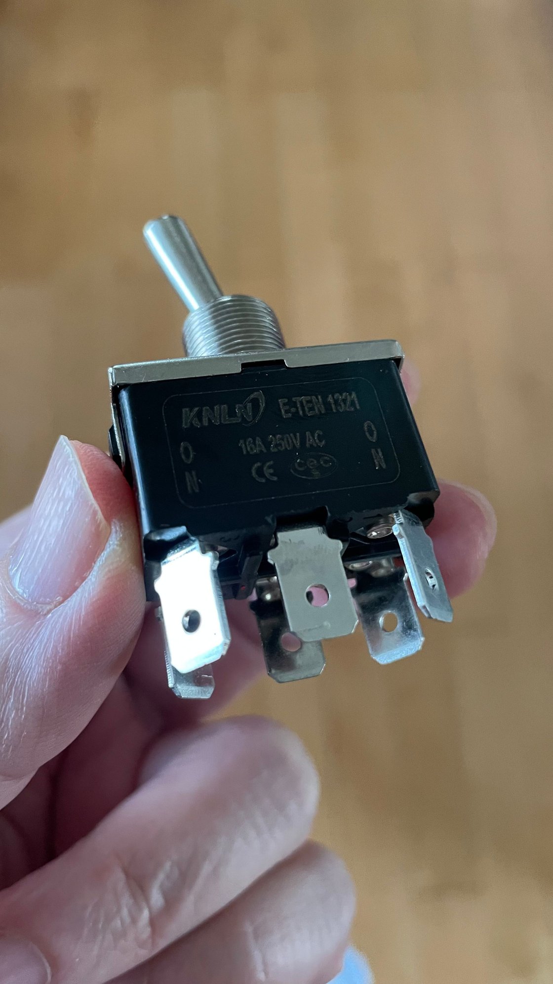

There is a bug with Beatsonic camera switch, whenever the power interrupted to CAN bud, such as disconnect the battery, the backup video feed is interrupted. The only way to get it back will require the reconnect the backup video to original feed, turn on the ignition, put car in reverse, then turned off, reconnect it to Beatsonic switch. To avoid hassle, I made myself a bypass switch for the backup video signal, and installed it under the dash. Whenever needed, I just flip the switch to reactivate the Bestsonic function.

Here is how I made the bypass and reset switch, I had is installed at the location where the opening for PCS switch (if the driver support package was installed, this area will have a push button switch for PCS):
