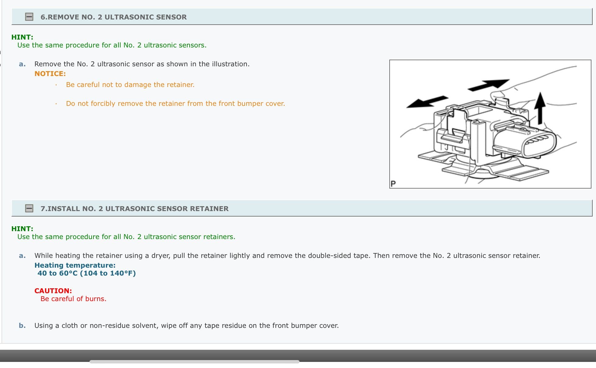

I'm suspecting it might be the rear right sensor. I bought the car used, had a really good service history with Lexus and no accidents reported. It wasn't until a month or so after I noticed that there's a small area in the right rear bumper that looks like it might have been repainted or touched up.
The service manual says the retainer clips for the sensors aren't reusable. If they were and they didn't have adhesive between the sensor and bumper, I'd swap the right rear with the right front (if they're the same part number). When I get time this weekend I'll go with my original plan of unplugging the rear sensors and harness, clean if necessary, put dielectric grease, and reseat the plugs.
I'll also check the resistance between the pins as shown in the service manual.

I don’t think you need to remove the retainer to remove the sensor
