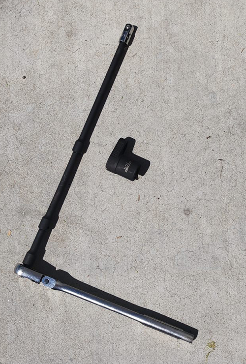

Simple tools to get the job done. I have the 22mm OEMTOOLS socket. The only thing I dont like about this socket, they put a big taper on the end of the socket, not sure why, O2 sensor "nut" is fairly thin.
Socket and just some long straight extensions gets the job done.

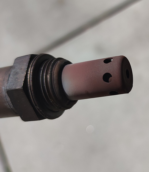

The OEM original sensor looks fairly clean, but tired.
