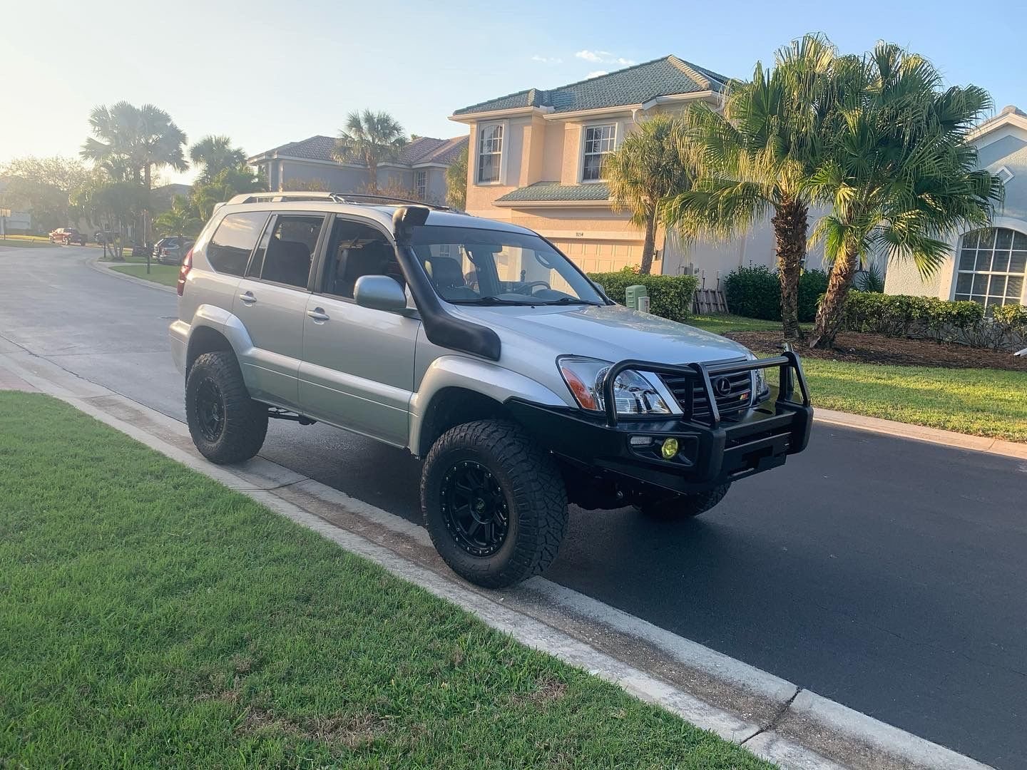

I’m sad…I pumped a bunch of cash into a GX and 1500 miles into the project the gears are grinding when going into 4th. It’s a sweet rig (not my daily driver fortunately), but this tranny has me mad...
206k on the clock, no rust, new dash, clean truck…I never would have thought the GX would have had a failure of this magnitude.
The goal was to build it and flip it (thought I could make a little $$$ since I did all the installs), but that plan is gone. Knowing the plan isn’t to keep the GX would you rebuild it (likely around $3500) or buy a used one (around $1400) and get it installed (I could do the install but really don’t want too), around $2500 (junkyard trans and install labor)?
Also, based on all my research a Sequoia/LX/Tundra trans doesn’t fit as it doesn’t have the same mounting plate for the console shifter like the GX…if anyone knows different I’m all ears (Sequoia/Tundra trans are about $700 cheaper based on my research).
