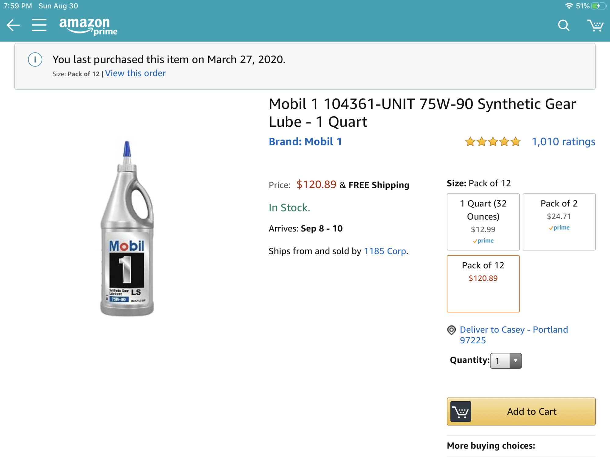

I not an expert on the value covers but if you would like to save some money I recommend you do the transfer case, front diff and rear diff yourself. It’s just like changing oil. There is a fill plug and a drain plug. Multiple videos on YouTube to guide you right through the process. I was able to get a case of 12 Mobil 1 75w90 for $120. It takes 6.5 bottles for one full service. Basically this should cover you for 50-60k miles. Here’s the link. Mobil 1 104361 75W-90 Synthetic Gear Lube - 1 Quart (Pack of 12)
Amazon Amazon
cheers.
