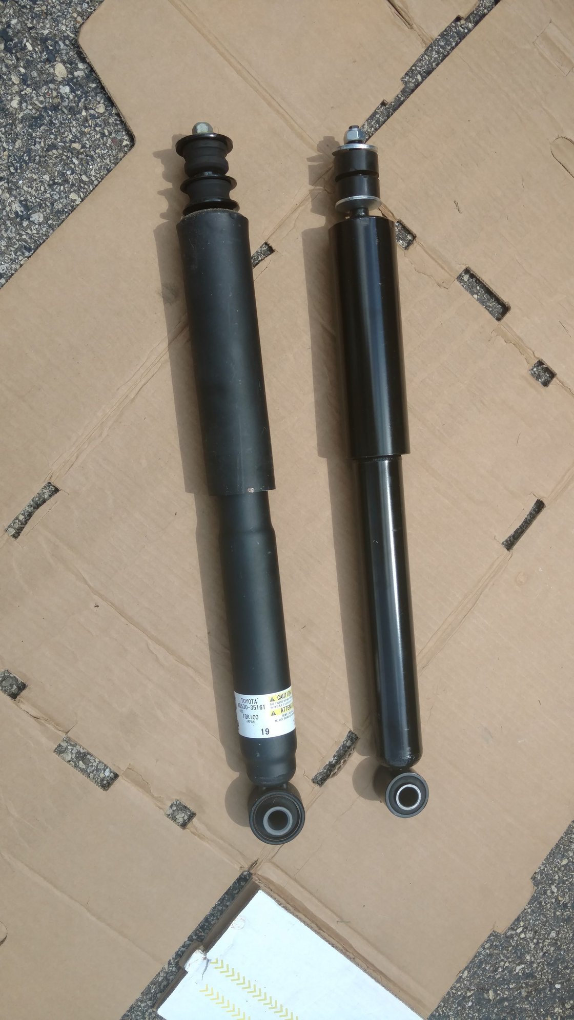

Not sure I can upload picts but the 4runner lower shocks mount looked the same at SunCore conversion. The TRD shock looked a little beefier, unsure of rates between the two. The TRD spring was about 1/2" shorter than the SunCore replacement spring. Appt Tuesday with my Indy to install. I'll compare ARS parts to the two replacements. Likely CL the TRD parts after the conversion.

Picture of SunCore replacement shock and 2018 4Runner TRD OEM shock.
