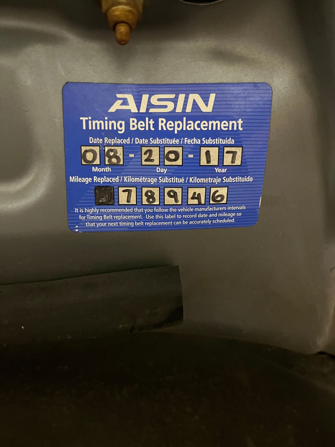

Here is a pic of the timing belt sticker I got with my first timing belt change at the dealer and I wrote in the new values when I had the timing belt done at an independent shop. Here is a pic of the timing belt changed which the shop took a pic. I guess my memory of the miles when I had my belts changed was a little off. Getting old.....

That's the same sticker I got on my 2nd change.
