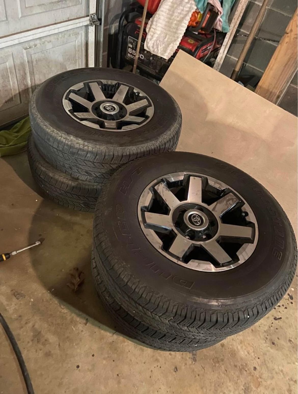

Still new to this! Will these 17s fit my 09 GX? I keep reading that most Toyota 17s will fit but I don’t want to make a mistake. They came off a 22 4Runner.

Bolt pattern should be identical…usually the only difference is offset…stock wheels I believe are +25 mm…usually 4 runners within 5mm…no issues there, I use 4 runner wheels for winter tires
