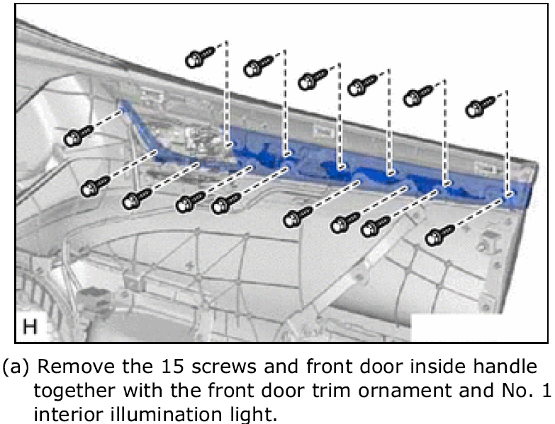

I posted this before when I swapped my trim, see here: https://www.clublexus.com/forums/gs-...l#post10327963

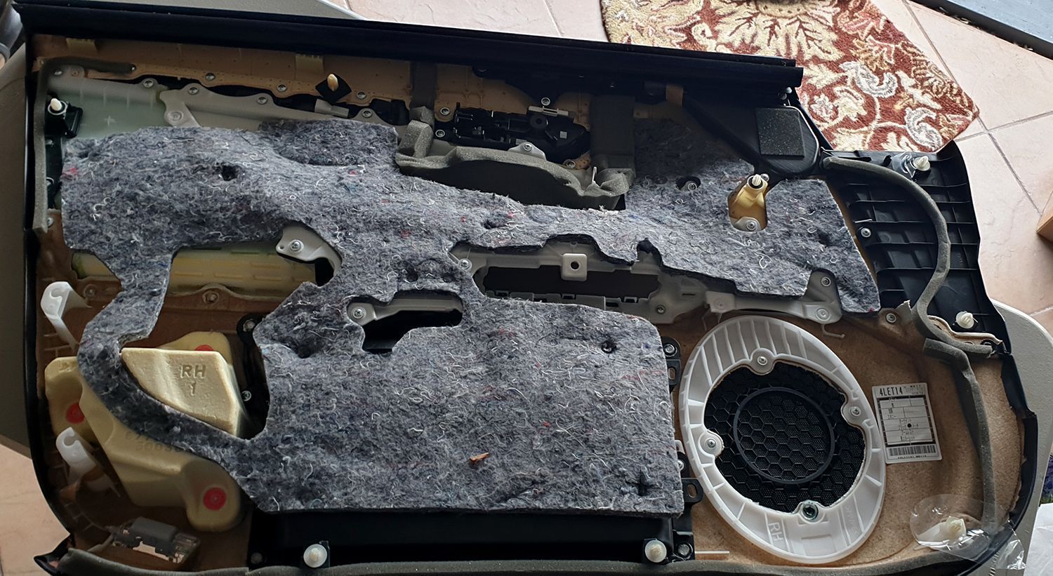

This video along with @eddie420 guide help me tremendously. Be sure to remove top channel guide first when you go to put door panel back. It's 1000x easier doing it this way. Watch this video, it's for an ES 300H but the process is very similar to our GS.
Tip: get yourself some door clips cuz you're bound to break some when you're taking off the door panels.
https://youtu.be/MblSE3cjfLU
