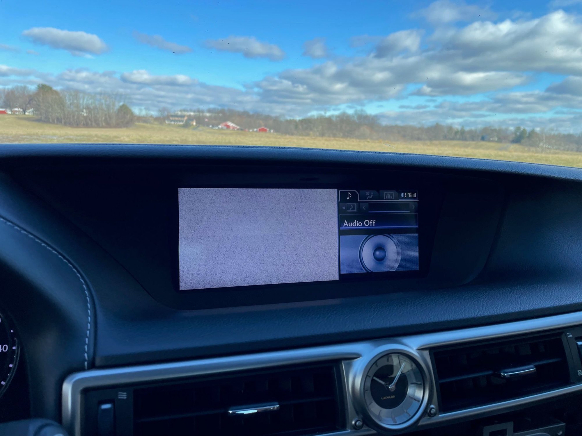

I ran into something today that I cannot find anywhere on the internet. I am looking for some troubleshooting guidance or anyone had experienced this, maybe the cause. First some background information. I have a 2013 GS 350 F-Sport with about 118,000 miles on it. Since I have owned it (Sep 2018, 88k miles) the GPS Location hasn't worked, and Microphone hasn't worked for Bluetooth or voice commands. I'm not sure its related but electronics problems so I wanted to provide that. I just receive my car back from the collision center to repair the front end from a deer strike. I was doing some research about the GPS and saw that some people would actually disconnect it for privacy reasons. I never thought to check if everything was connected. Now to the problem.

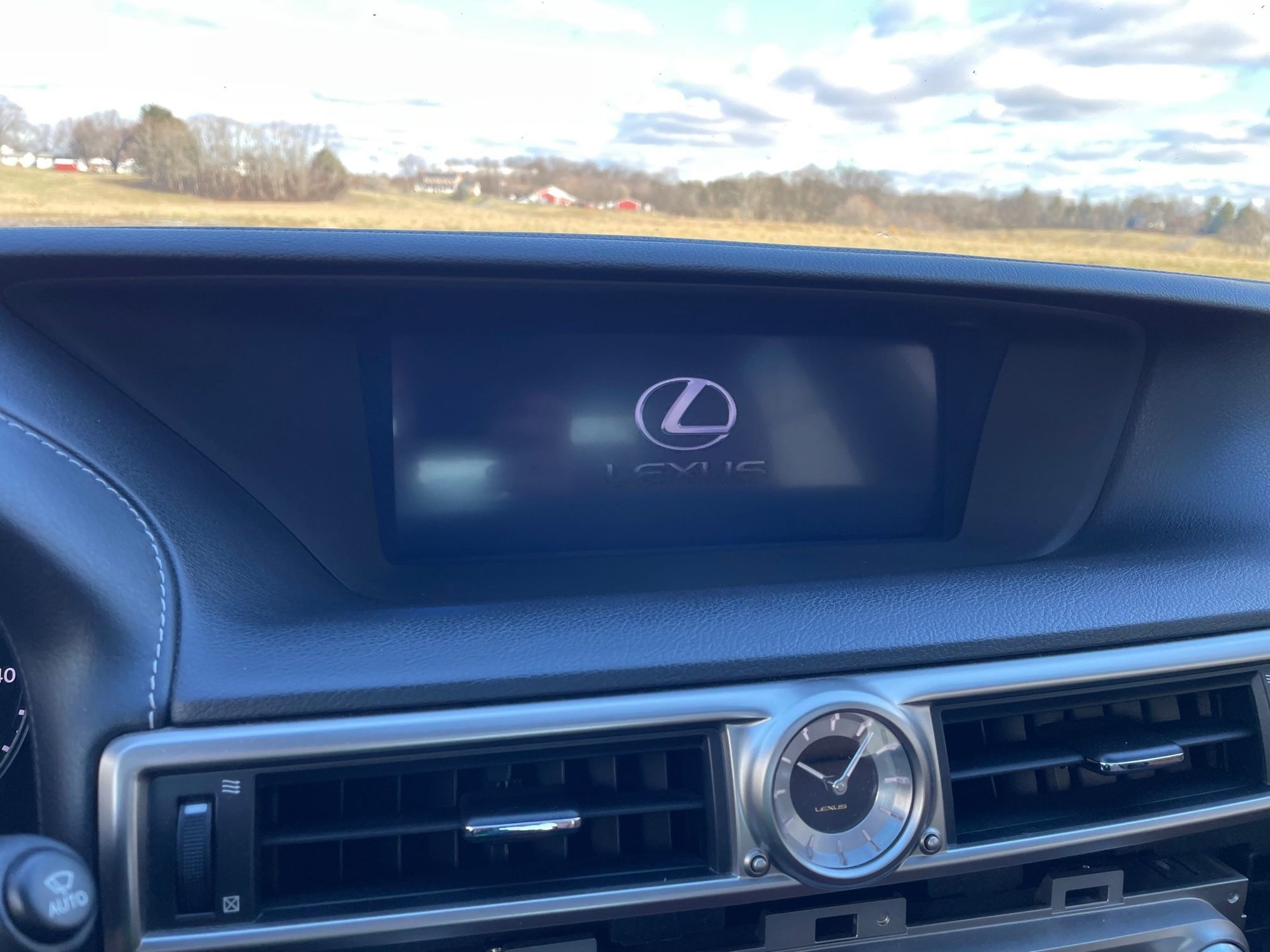

This morning I removed the bezel surrounding the radio and removed the 2-10mm bolts holding the radio in. I pulled the radio out to make sure all connections were plugged in. They were. I reinstalled the radio when I started the car back up, the left half of the screen was static. Everything still works, radio, HVAC, etc, but the left side was static. When I started the car, the whole screen lights up with the Lexus Logo, and when I press the menu button to takes me to menu, but if I try to select something it takes me back to my default half and half screen with left half being static. I took the radio back out and ensured all connections were inserted and I didn't inadvertently knock something out then I disconnected the battery for about a half hour to try to reset it. Hooked it back up still the same. Then I held the power button down to reset while it was running and left side turned from static to white, still with all of the same issues. I am having trouble uploading photos but will keep trying to attach to the thread.
Any ideas on what is wrong or what I can try to fix it? Thank you for the help.

Looks like the display cable might have a bad connection. It’s the blue plug on the back of the head unit goes directly to the 12.3” display. Take the plug off and inspect both sides of it.

It does seem to be the connector into the back of the head unit. I inspected the connections at the head unit and the screen and nothing visible looked wrong, but once I got everything hooked back up, I wiggled the connection at the head unit, and it cleared up. Now I just need to find the sweet spot and get the head unit back into place without it moving. Thanks again for the suggestion.
