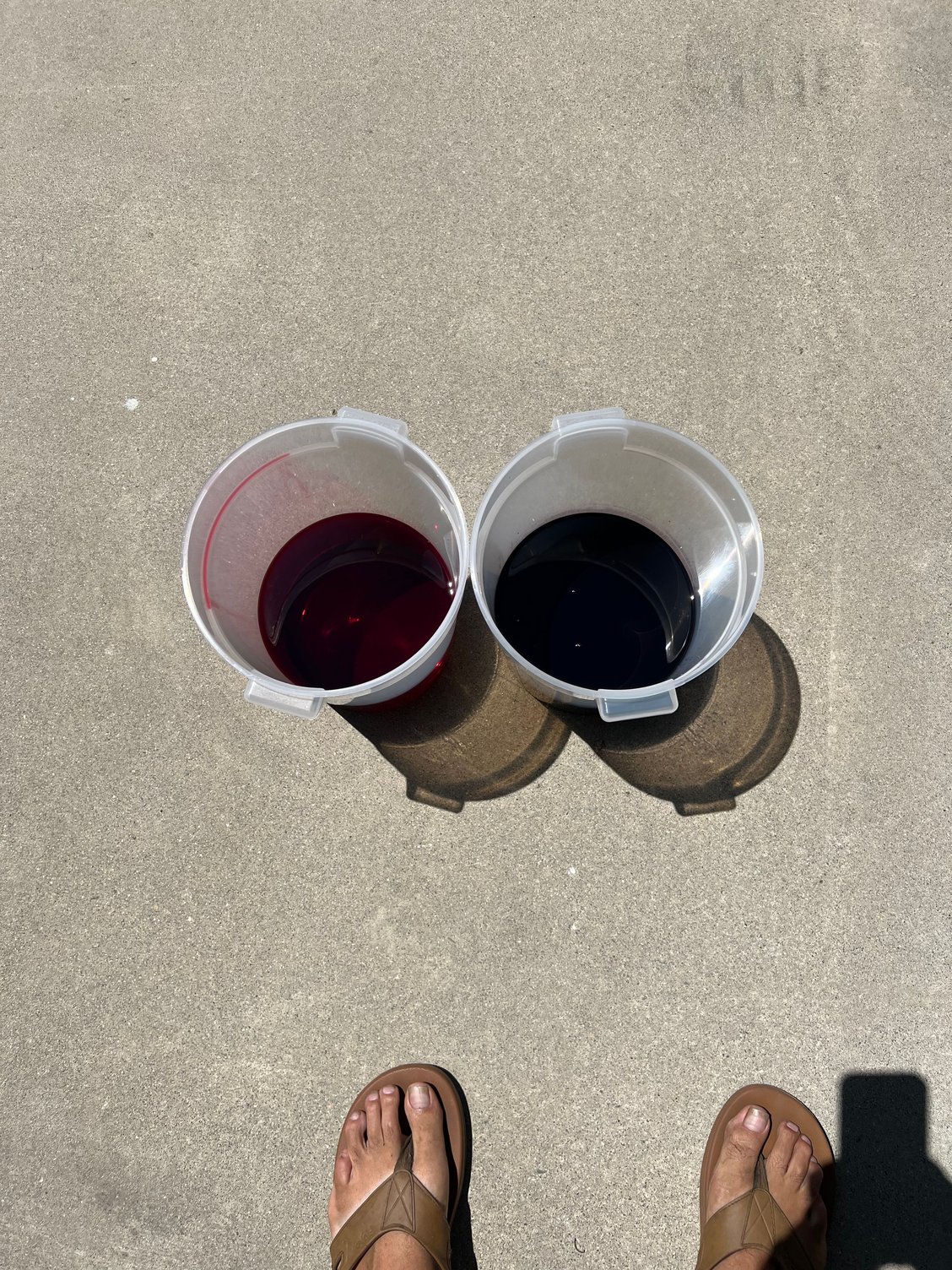

Originally Posted by asciarra21
We just picked up a ‘19 RWD with 32K on it and I will do the trans and diff in the coming weeks.
So unfortunately just getting around to do the trans drain fill today at about 38K and I wish I wouldn’t have waited. Look at the pics of the drained fluid compared to the fresh trans fluid.
I can’t imagine it getting this dark (kind of purple-ish) in color in just 38K. Scratching my head.
It will look like that again in about 5,000 miles. Unless you completely drained everything, there's more than half the fluid still floating around inside of the case. All you really need to do is get the additive package boosted and 3-4 quarts of new fluid will do that.
I drained and refilled 4 times today.
it progressively got better but nowhere near where I’d like to see it.
I am still beside myself trying to understand how in less than 40K it can be that dark.
In a week or two I’ll do another set of drain and refills and I’ll report back.
Don't look at the color of the ATF to determine its quality (i.e.condition) or effectiveness. ATF turns really dark very quickly - that doesn't mean anything negative. No more so than your dirty feet means anything negative about you!
Lol, what do you mean dirty? That is my natural skin color.
Just kidding, I said to myself after posting the pic, I probably should have cropped my dirty feet out it the pic. Now I know I should have lol.
Yardwork and car work will shower after.
Still waiting for the dang transmission temp to drop below 115F. It’s so dang hot here in SoCal that I have no idea when I’ll be able to adjust the fluid level, maybe midnight.

Originally Posted by jgscott
How many years? What year is your car? Break in metals and other substance.
I have a 2013 with 42k now. Did the exchange 3 separate times. Each time 2 exchanges and a short drive to mix and flush each time. Filter once. The exchange rate 1 time gives you less than 20% new fluid. If I remember correctly b/c had a chart he posted with the exact percent of new vs old on a drain and fill.
2019 with 38K on it. Appears to never have been done before. Bought it last year CPO with 31K.
Yes I remember doing my wife’s 2007 GS350 and I first did it at 120K. So black took many sessions of drain refills to get the fluid red again. And did notice the shifting was smoother than before.
