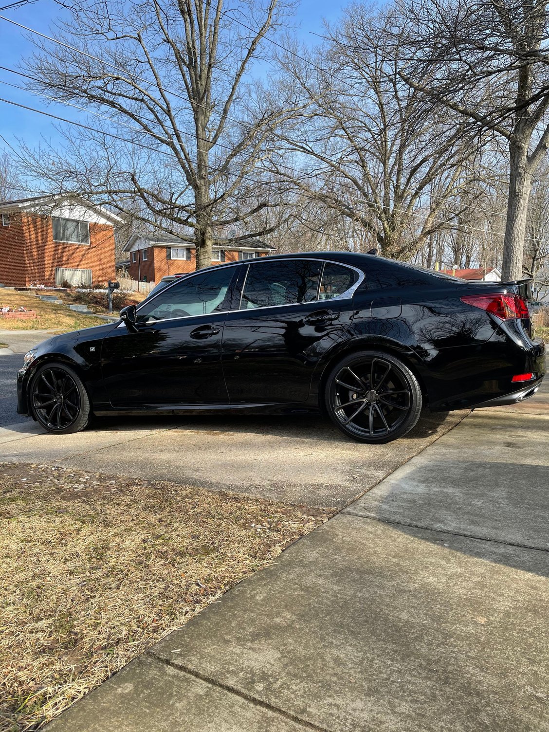

GS350BO's Avatar
GS350BO
Joined: Jan 2020
Posts: 106
Likes: 55
Default Here’s mine
