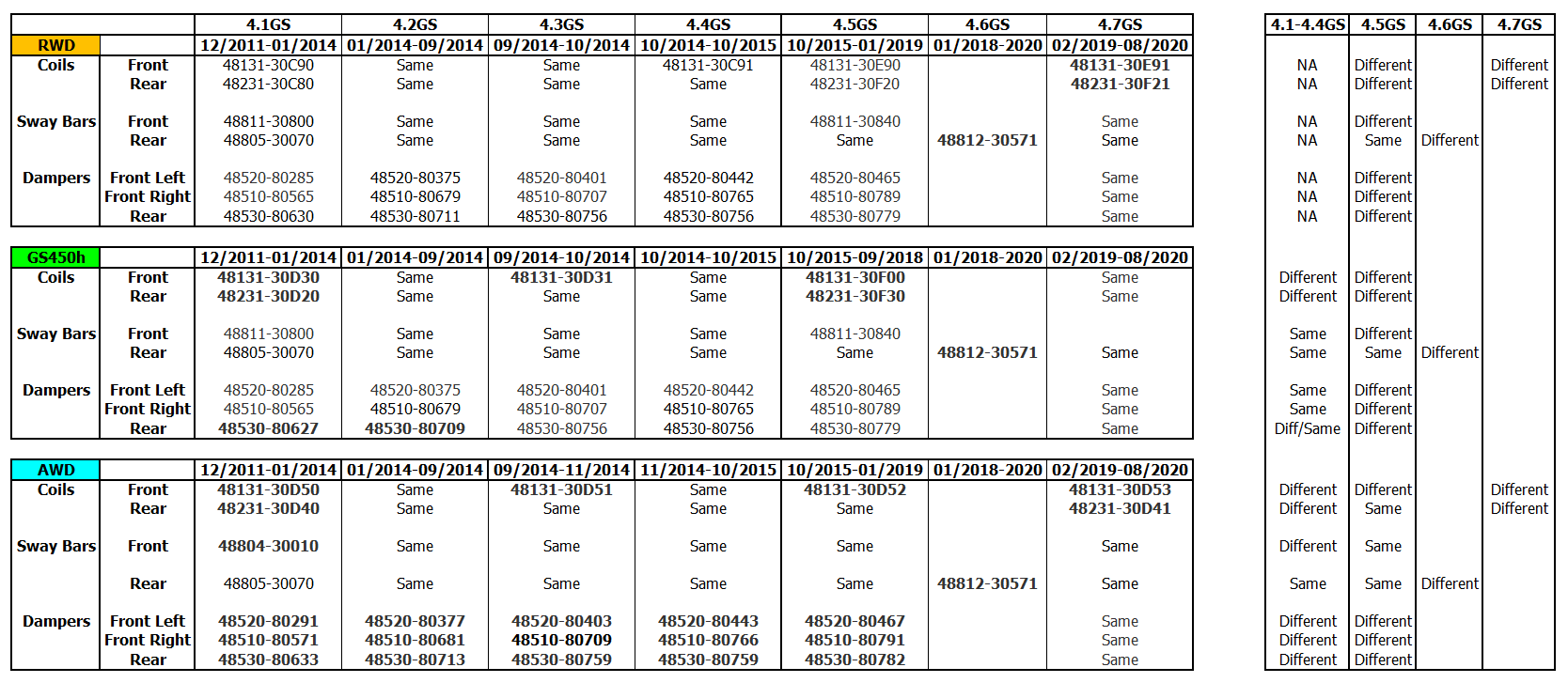

I have a 2013 AWD F Sport with AVS. Can any of you provide me the correct part number for the rear shocks? I've read some contradictory information where some sites say the KYB 5540013 supports AWD and AVS and other say it does not support AWD. Any help will be greatly appreciated.
JP
See the OEM chart below with AWD rear shock absorbers [dampers] for the appropriate build date.
This chart below is only for Luxury and F Sport, which use the same suspension part numbers, though F Sports does have 4 wheel steering etc.
