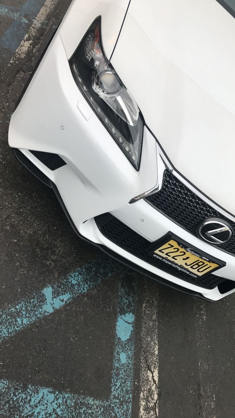

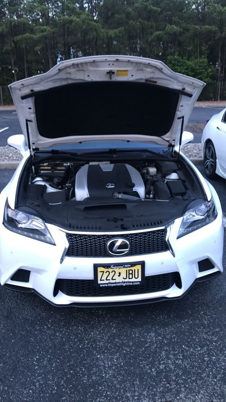

1. It hasn’t come off while driving. Hit a few times when going into drive way and garage and it hasn't come loose . It’s been on the car for about 2 years now.
2. I did not bother to get it painted. I have a few friends that are professional painters; they told me the paint would start cracking after a few years.
3. I bought a cheap one from ebay. Nothing fancy or too flashy, as I just wanted a subtle look and for the front to look a little lower. I believe it was $60 or so and paid $25 to get it installed. This one comes with about eight screws so its pretty hard for it to come off. I only put 4 on my car as I did not want so many holes drilled onto the bumper in case I ever decide to take it off.
Link and picture of the lip

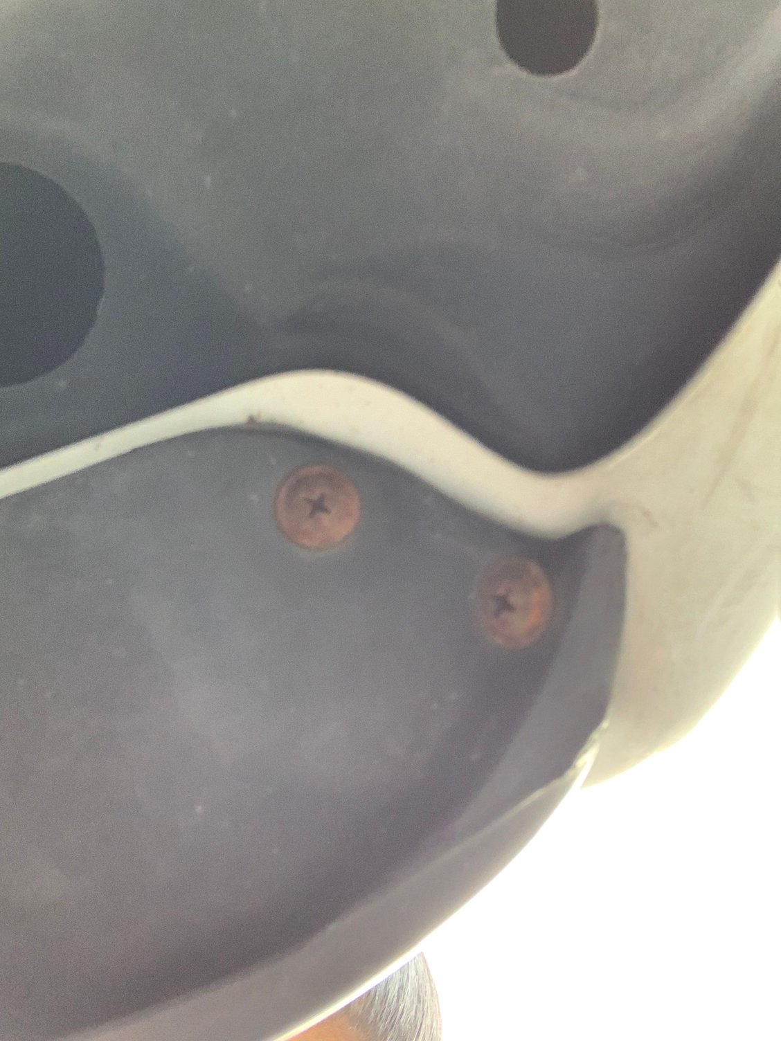

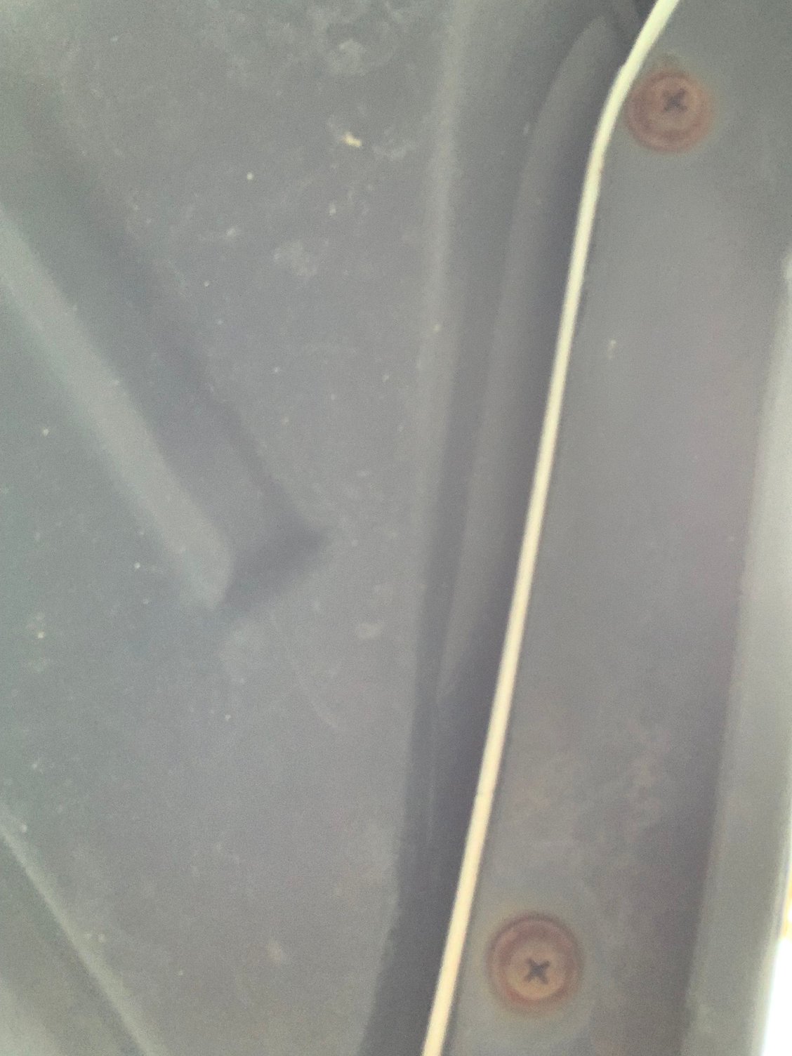

Can anyone post pictures or explain how you secured the sides to the bumper? Screws or double sided tape. It looks like the side of the bumper is very thin to put a screw through- part inside the wheel well

Kept forgetting to take pictures. Hope that helps. In the corners they used two screws as you can see.

Those screws should be made of stainless steel so they don't rust and disintegrate. Those screws already look well on their way...

Yeah, I never bothered to look at them until I went to take the picture. I live up North and close to the ocean, salt and snow sure don't help 🤦🏽*♀️. I will look into getting them replaced.
