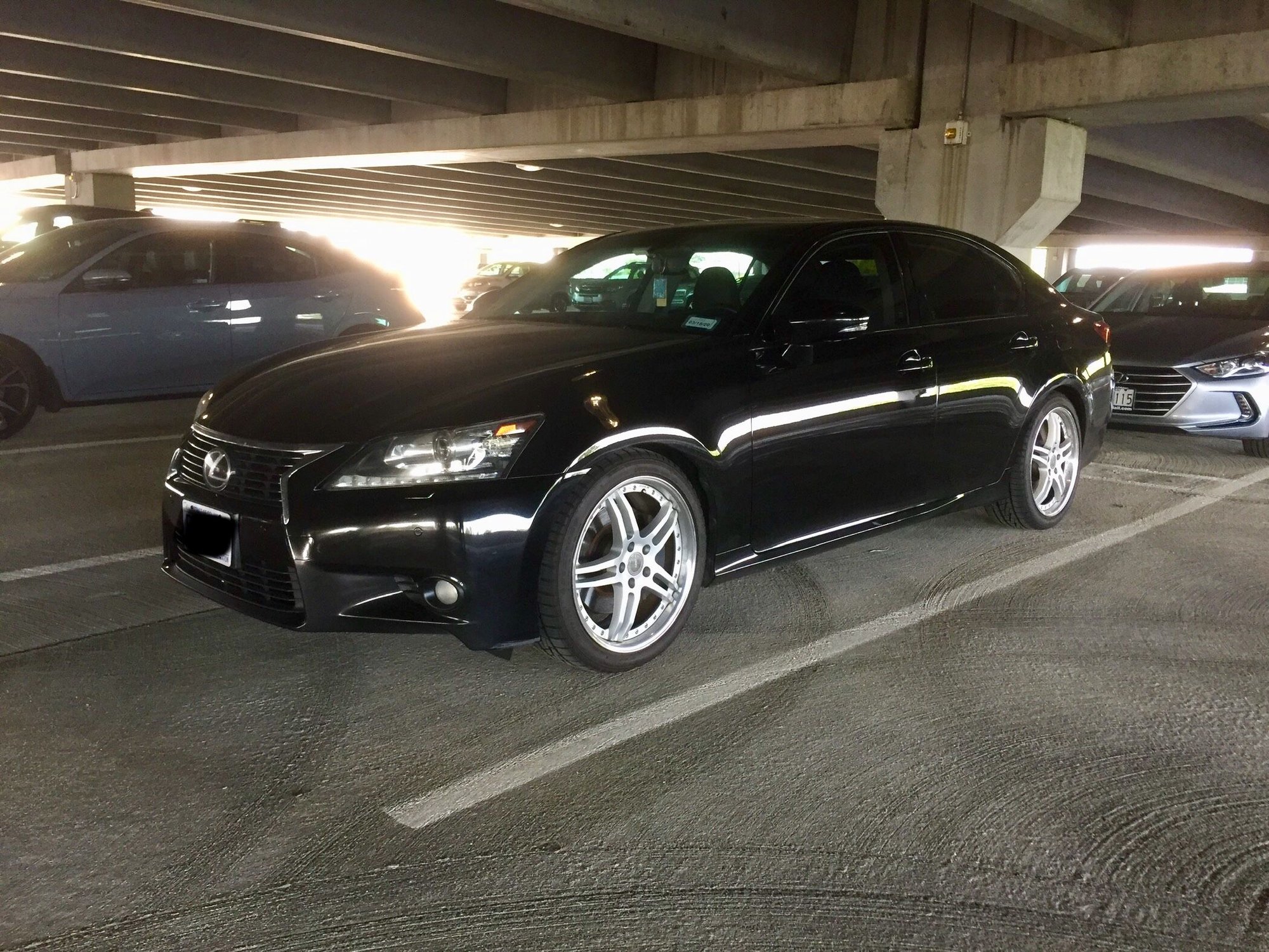

Posted this is the other thread (don’t remember the name) but here’s my 2013 AWD. Dropped on RS-R Down springs.
Work Gnosis GS-2
19x8.5 +38 (square set up)
Sumitomo HTR A/S P02
245/40/19
No fender work at all since this is a conservative set up. No rubbing or any issues. I don’t know what the camber specs are but when I had the alignment done it was all within spec according to the Hunter alignment machine’s printout I was given.
