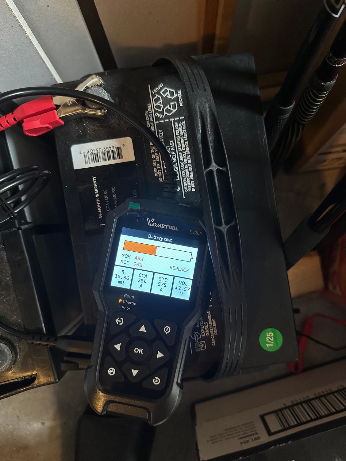

I ended up taking my battery back to the dealer and talked to a service tech that ended up being a super fun guy to deal with. Once I explained to him my side of what happened, he gave me a new battery at no cost. He commented why I had to go through him to get this done that it should have never gone past the parts department. My observation over two visits was that every thing was getting punted to him constantly. He is the guy that gets sxxt done.
Here are the measurements of the "old" and new batteries with my tester
new

Glad you finally load tested that problematic 'old' battery (and found it to be bad and needed to be replaced), and were able to deal with someone at the dealership with common sense. Too bad it took so long to get it done...

Yep! We just couldn't get that to sink in... All one has to do is look at the voltage in the image (see below) that says 'REPLACE' the battery - it's 12.57 Volts. The health of a battery is NOT determined by its voltage.
