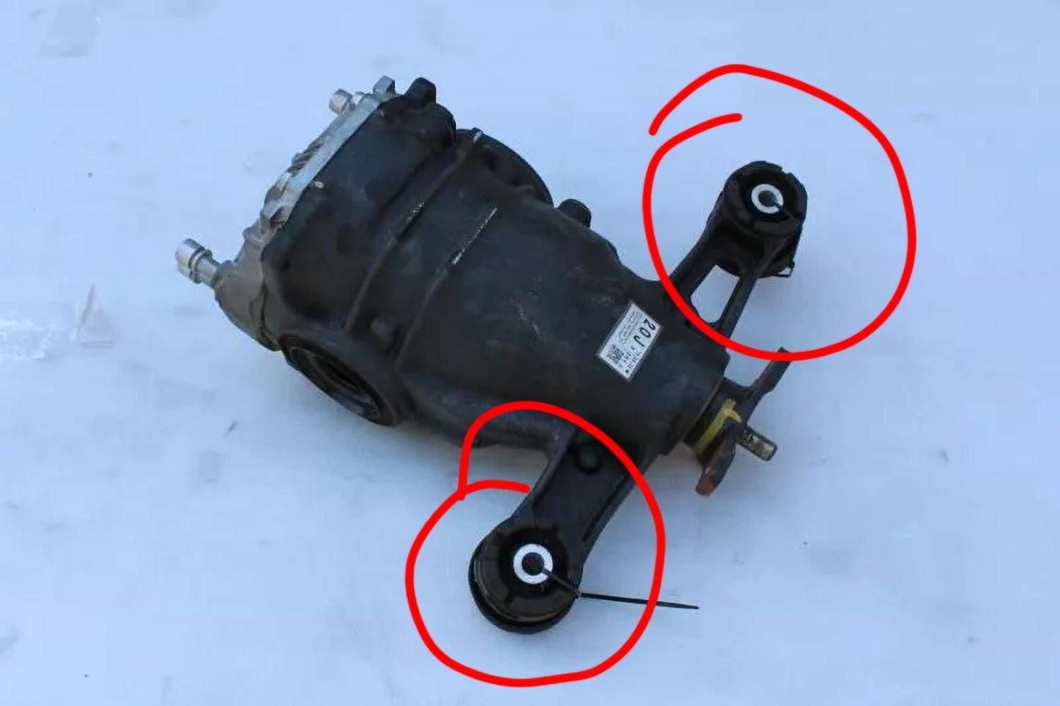

My car now has 130k miles and I've been noticing for a while what seemed to be extra movement from my rear end, a bouncing feeling sometimes that can interrupt power delivery (my suspension is sorted so I know its not that) and driving in manual mode around town has been clunky/jerky for as long as I've had the car. Letting off the gas in manual mode even causing the car to buck from the power cutting and engine deceleration happening. I got the diff bushing set from Figs and went for the "performance" option which is a harder polyurethane than the stock replacement.
The first day of in town driving I noticed that the shifting felt much smoother as in no jerks/jolts felt from inside the car. The shifts happened quicker because now when the power is being sent to the rear end there is no compression, decompression of the bushings before the input is felt. Everything stays in place and the shifts as well as any kind of throttle input just goes right down the line and translates to being felt faster. This includes off the line acceleration, since the bushings are not compressed while stopped, soft and worn out bushings will compress before the acceleration is fully transferred..the stronger bushings just keeps their place allowing the power to be transferred and felt a bit quicker. The rear end also just generally felt way more solid and stable.. if you've done the Figs LCA bushings you'll know what I mean. I discovered manual mode was not acting jerky around town in low rpms or mid range and I even tried to upset it by kind of pressing and releasing the throttle sharply at different rpm ranges in 2nd and 3rd gear. The strength of the new bushings didn't allow the diff to make me feel that bucking feeling thats felt from the drivers seat, the car remained steady when abruptly letting off the gas from the inside the whole time. Since the diff is suspended by these bushings I believe that some road bumps and vibrations caused it to bounce or move around which could be felt in the car, a few places I've noticed less extra movement coming from my rear end as well.
Today I went up to the mountains to get a feel for any changes in handling which there are supposed to be with this upgrade and holy ***** was I surprised. For anyone who doesn't know, my car already has coils, very light weight wheels, every chassis brace available from strut towers to the entire subframe, sway bars, and other superpro bushings to keep it short. My car handles really well but I did still get a bit of initial body roll when entering a corner and when exiting that bit of roll would then level out once I was straight. Today the car felt like what was left of the body roll or twisting feeling was gone.. just gone. Turn ins remained extremely flat, it felt like there was more grip and when exiting the car didn't need to level out because it was already flat so the corner exits were smoother and seemed faster. That overall stable feeling I mentioned earlier was evident here too. Since the throttle inputs no longer are effected by squishy bushings, going on or off the gas in a corner was much smoother as well. A friend was behind me on the drive and when we parked he came up and said, your car didnt roll at all, it looked so flat and planted. I was honestly really surprised how much that aspect changed. I feel like the improvement in handling is a huge amount and that makes me really happy.
This bushing kit doesn't add any NVH, it blends in as if were stock. The install was pricey because its work on the subframe all in all with the parts, install and an alignment I'm in about 1,100 but its so worth it. To sum it up, the car feels more stable and put together, the shifts and throttle inputs feel quicker and smoother reducing in car felt jerkiness by a ton, it improves the handling and grip drastically, and it didn't come at the cost of making anything uncomfortable.

These are all great upgrades to improve the car’s handling but if it was feeling sloppy then you want to figure out what was causing that and once it’s resolved it will really feel tight. Did you check the rear suspension knuckles on the outer end of the lower control arms? These are always wear out and make the rear feel sloppy

The things I was feeling were all fixed from changing the old worn out diff bushings. The rest of the car is doing good. 130k on them and were all cracked and wrinkled when they came out. I had this mod on my mind for at least a year and I think I read an article or post that confirmed the things I was feeling was from worn out diff bushings so I decided to go for it and happy I did.
