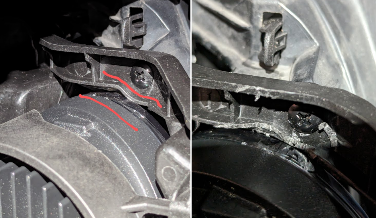

Just a heads up, if buying the eBay/Amazon kit. At least with diode dynamics Elite fogs, I had to notch the bracket a little to let fog light be adjusted properly.
Also, for that same kit, one of the connectors to the fog light wasn't making good contact, so one light would flicker until I adjusted the connector.
