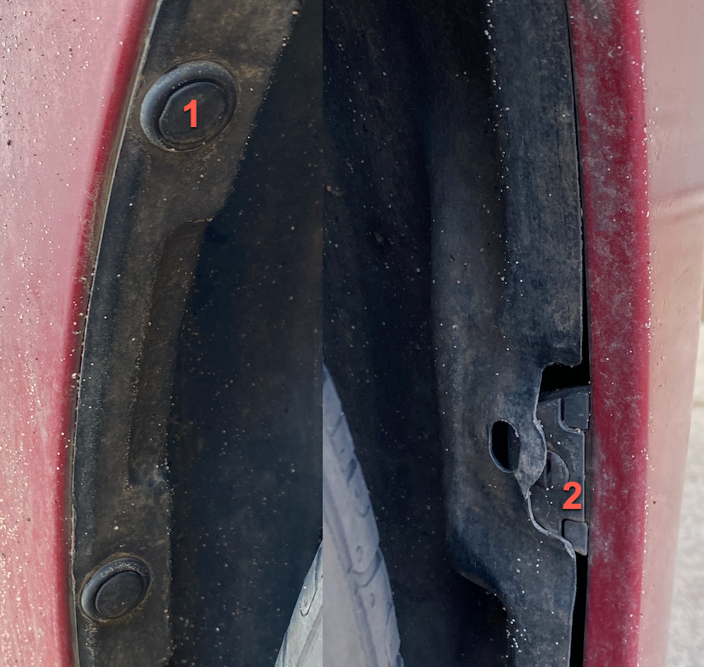

I purchase this old 2015 GS 350 and we later found out that it has a few cosmetic issues. How do I find tuck this back in and make it stay there?

1st picture. It looks like the tab needs to be repaired. A bolt/screw usually holds up the corners of the bumper into the fender.

I'd remove it and plastic weld the broken tab with a soldering iron.
I'm sure you can find enough spare material behind the bumper to weld it.

Anyone know what these clips are called? Looks like I may need a couple. Thank you.

Push clips (I haven't used the ones below, more just giving an example you can search by)

#1: Bumper Liner/Push Clips
#2: Fender Liner Clip w/Pin Retainer Clip: https://www.ebay.com/itm/183399288805
