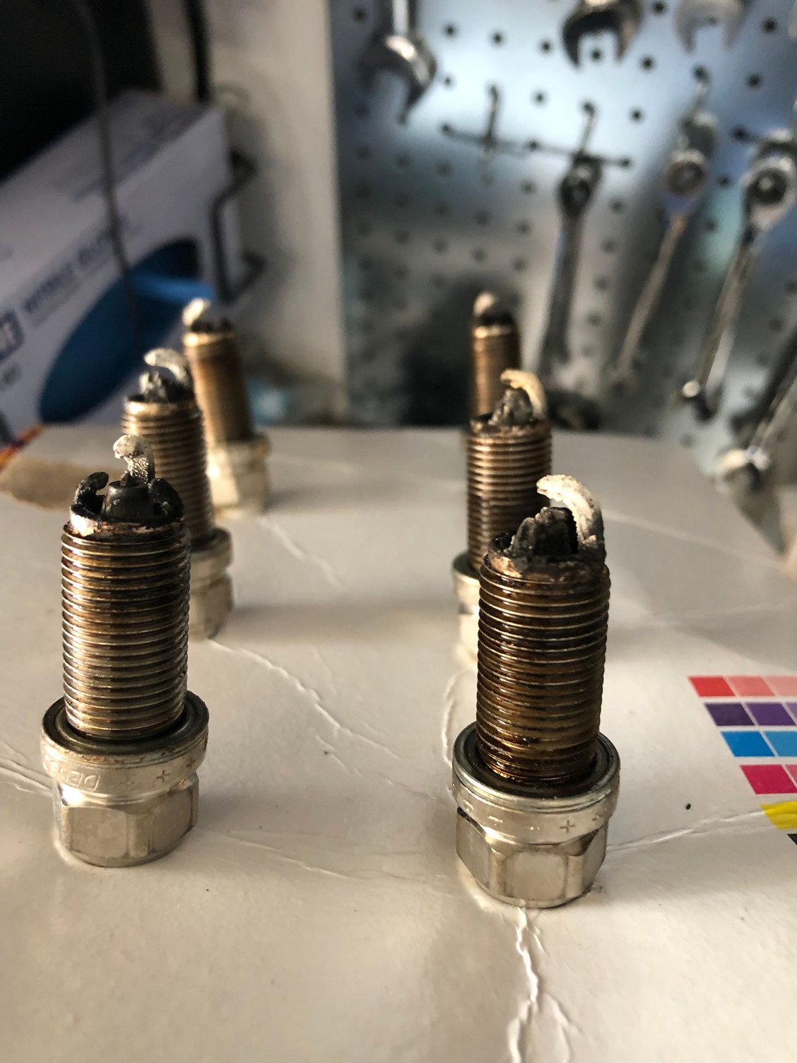

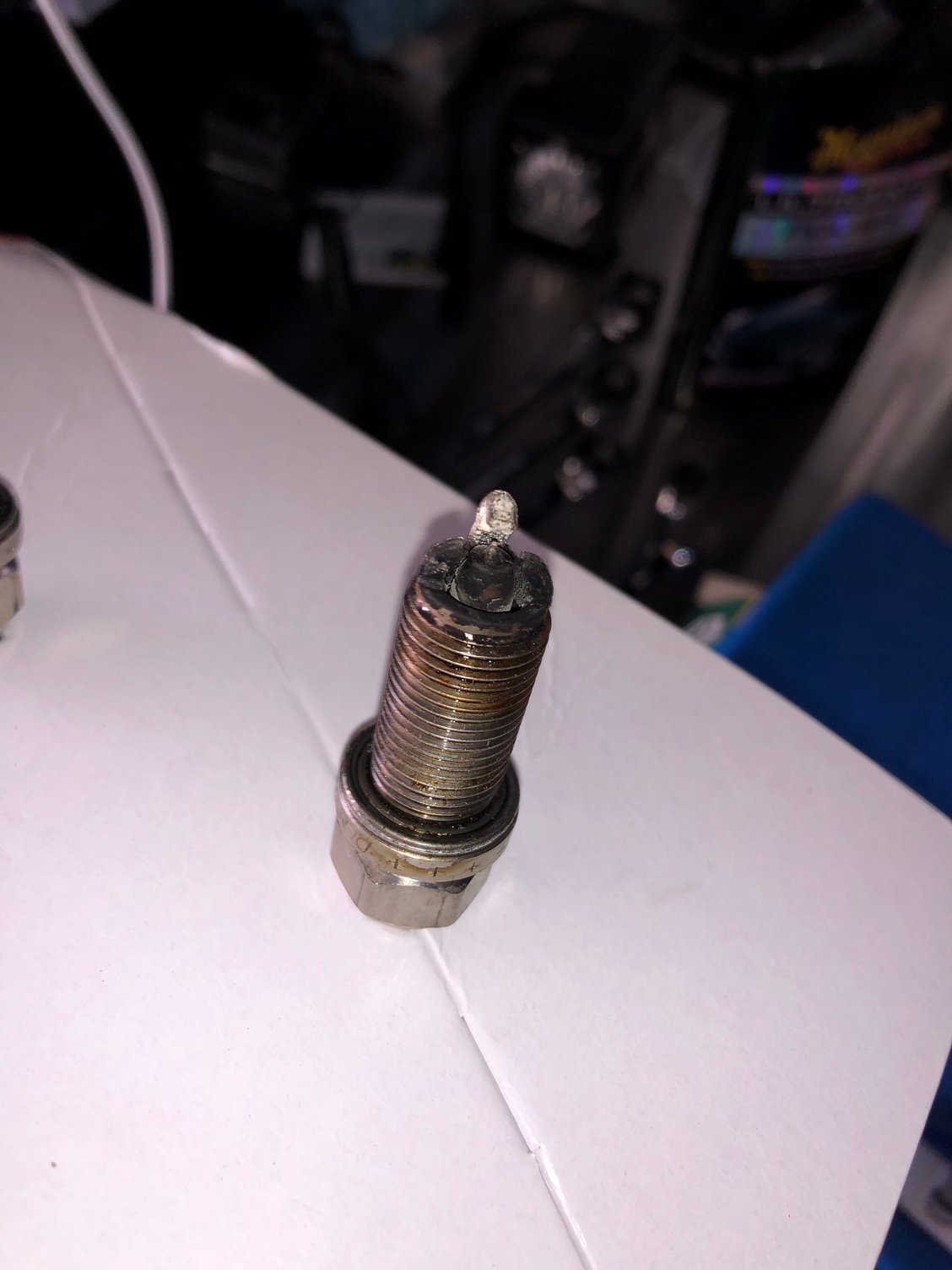

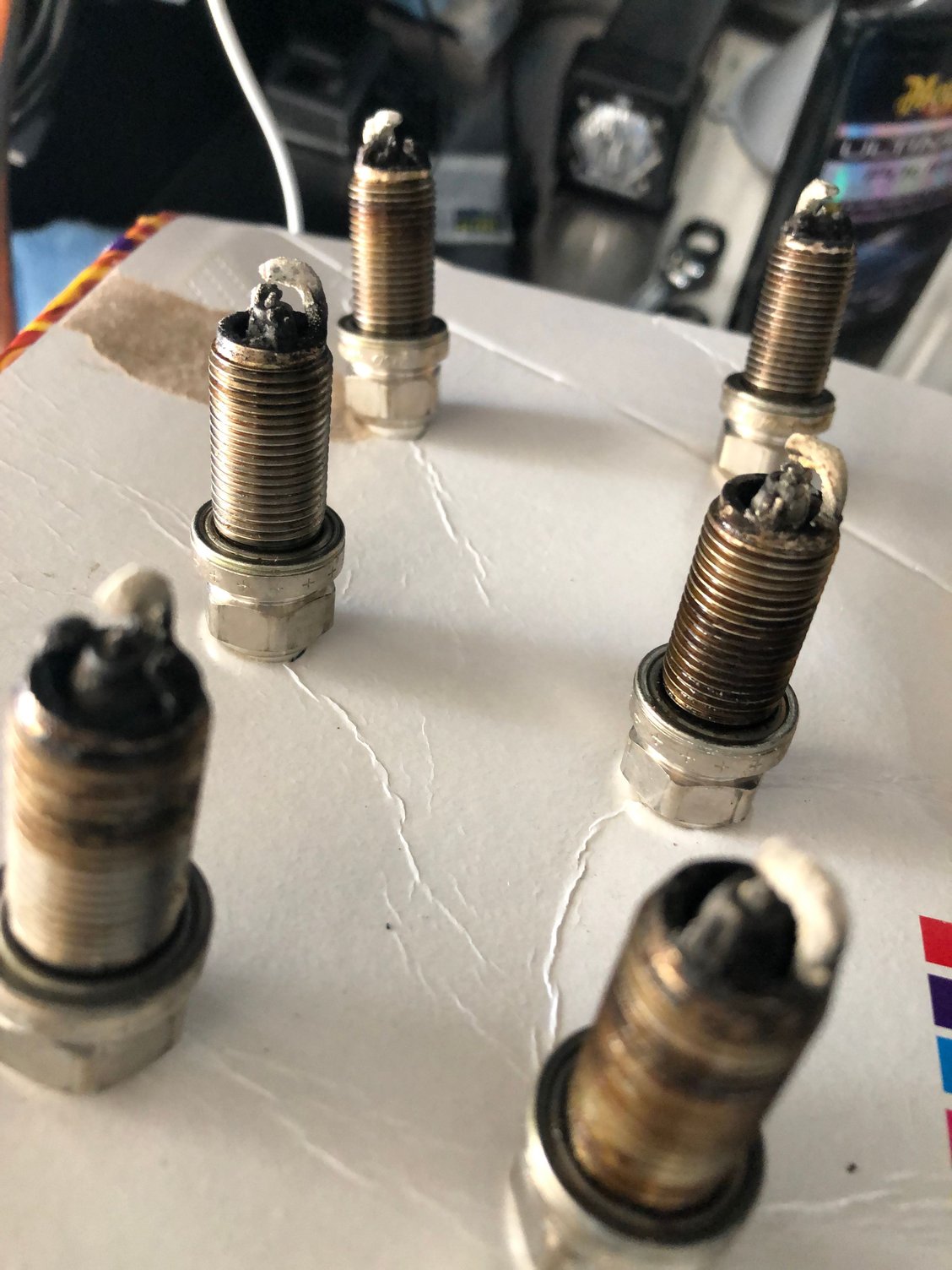

Hey y’all, I’m not as active on the 3GS subb these days since but wanted to share what 100k OEM plugs look like.
Some background, I bought my 2007 GS350 back in 2010 with 40k on it and had the dealership changed the plugs around 60k in 2012 or so. Well, today the car has 168k and I did a DIY, took me a little over ONE hour for 6 plugs. I went DIY since I’ve been reading dealerships are charging about 3 hours/over $500 for this. I used simple tools, a ratchet wrench, multiple extensions, 10mm and a magnetic spark plug socket.
do what you want with this information and pics!
