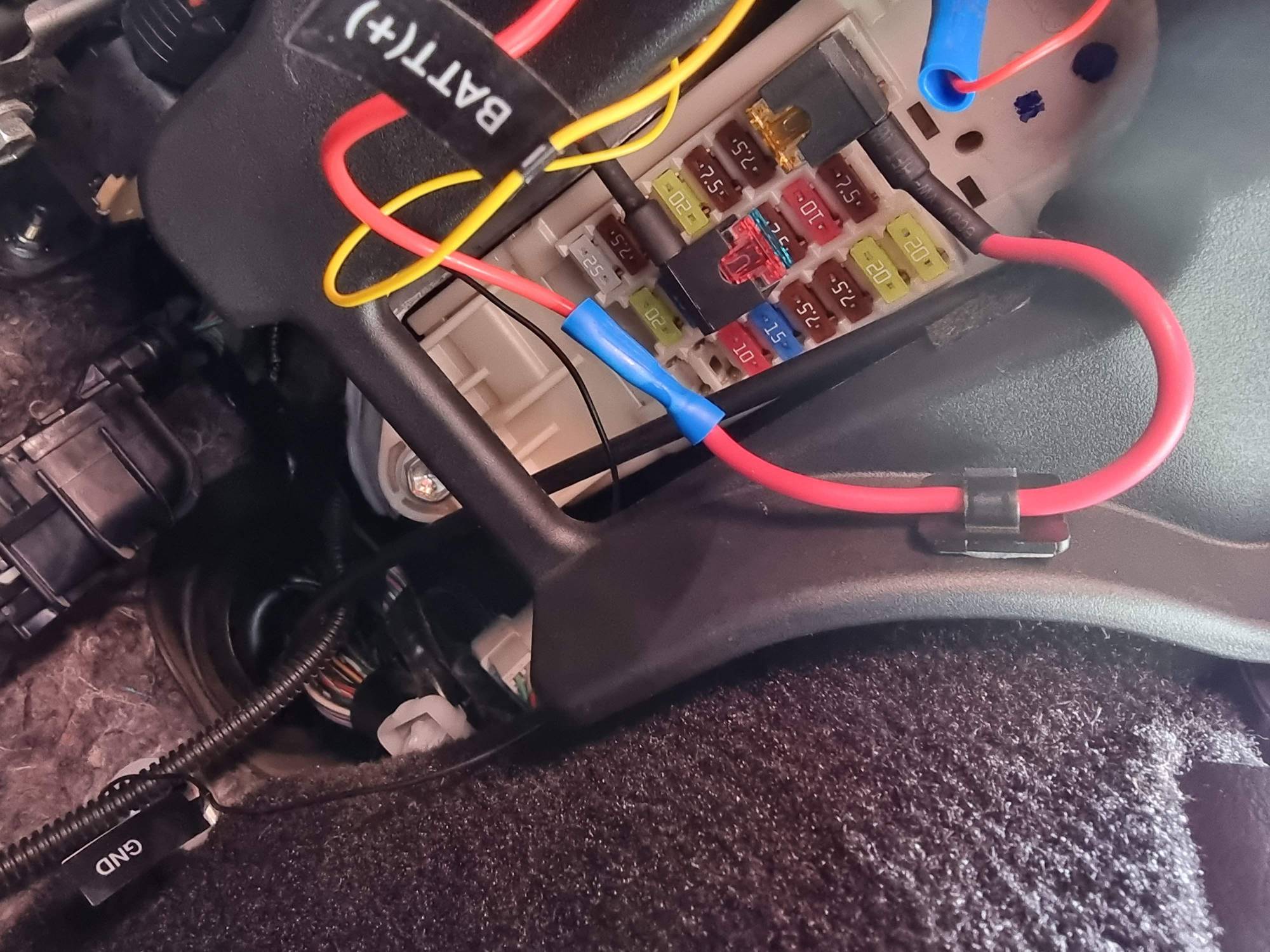

I used fuse taps to tap into the cigarette lighter fuse below the steering wheel
Took a bit of effort to route the wires behind the A-pillar airbag (rather than across it)
I can send photos if you want

Didn't pull the full A-pillar off.
Most of the cables can just be pushed behind all the fascia and panels easily
Using Fusetaps for power
