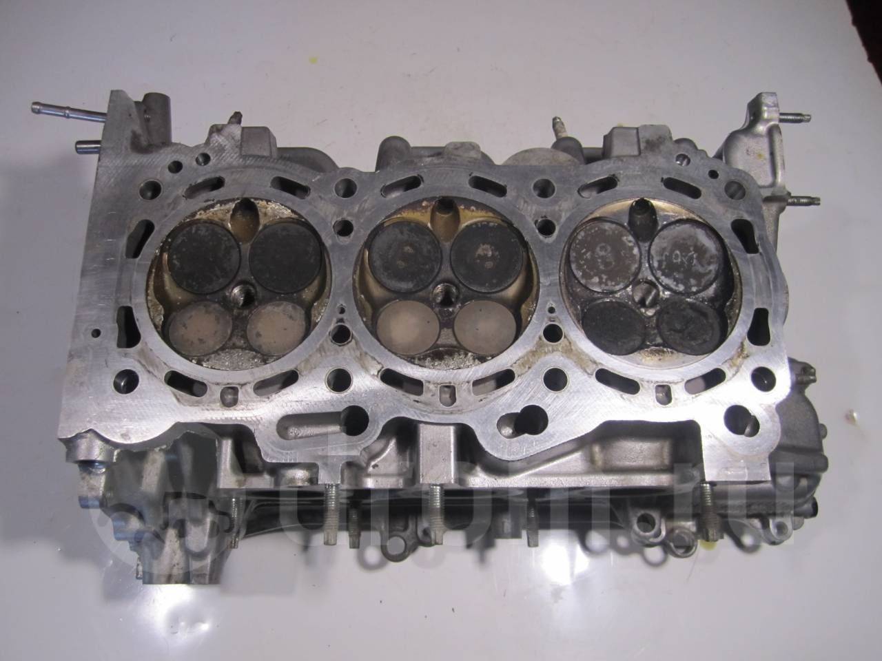

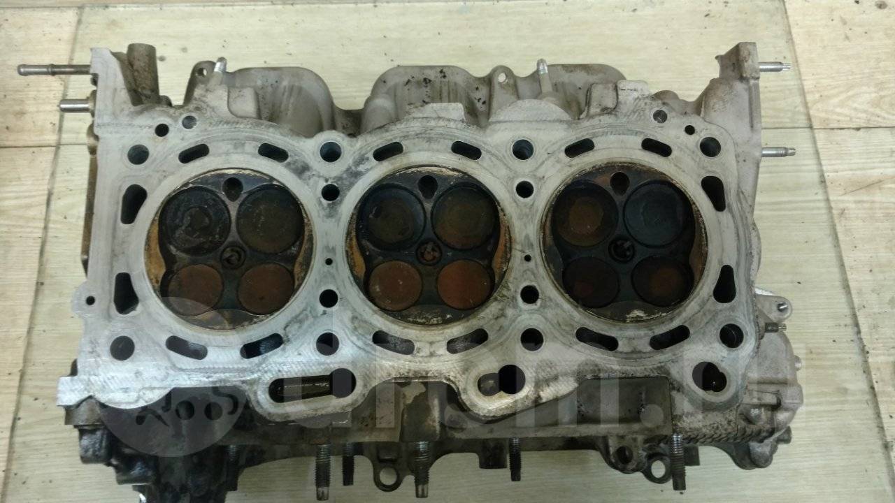

Here's what I've found, both the 2GR and 3GR head/blocks, I dont see many drastic differences in the passages, could be wrong
2GR:
3GR:
