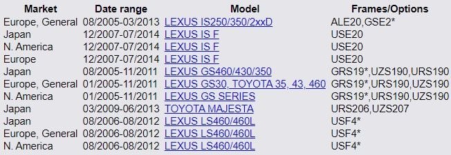

The spool in 41110-30A90 fits all these models in these global markets as well:

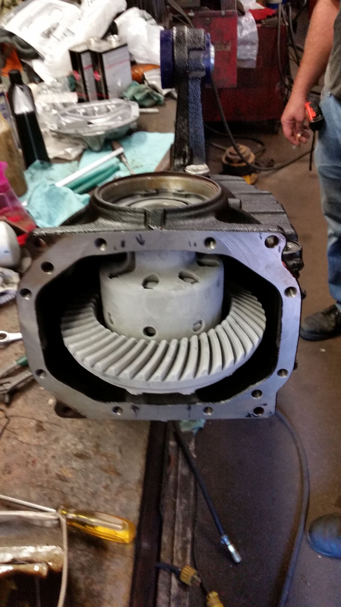

This blog post details the necessary clearancing (if you choose this route, there is another option, but it requires a stub axle and some very quick work). I clearanced mine.
http://figsengineering.blogspot.com/...tallation.html
This is mine after clearancing - the black arrows show where the case was widened on both sides:
I was extremely careful to only take as much as necessary. The spool had to be clocked correctly to fit into the housing, even when frozen as you see in this picture. Tooth engagement did not change with the OS Giken install and the original snap rings and bearings. I only replaced the seals because everything else was still in perfect shape even after 250k km.
Nope:
...unless you've inferred that this spool can fit in the (I suppose) bigger diffs. N.B. - the 50031 looks backwards compatible with the 50030, according to the cross-reference, at any rate.
I suppose you looked up 41301-53040, since it is present in the ALE20L-AEFSYW config of the is220d (EU LHD spec). That's a different diff assembly (41110-53280, also present in 41110-53170, again on the is220d).
So, unless I'm missing something obvious, the issues are:
-there is no (confirmed) equivalent spool to the OEM open spool. Here's somebody that tried (one of my original references, along with the supraforums/mk4de/etc databases, my.is, all the info here... etc, etc).
-there is no (confirmed) high gear ratio final drive kit (>3.7) for the big torsen spools (IS-F/GS-F/etc... the Mark X GRMN is an unsolved mystery). edit: I've read about all the IS-F with IS350 diff swaps and etc, cross-referencing 42330-30160 (for example) gives it all away
-the small diffs (is250/gt86/etc) require a flange mod and a subframe swap
-the old diffs with bolt-on axles (supra/aristo/whatever) require modifying the old axles by machining out the ABS rings
edit 2:
Also, the rear subframe from the 2IS applies to all models in all markets along with a range of other Toyota/Lexus options.
Nope. The IS250 and GS300 share subframes. Everything else uses a different subframe.

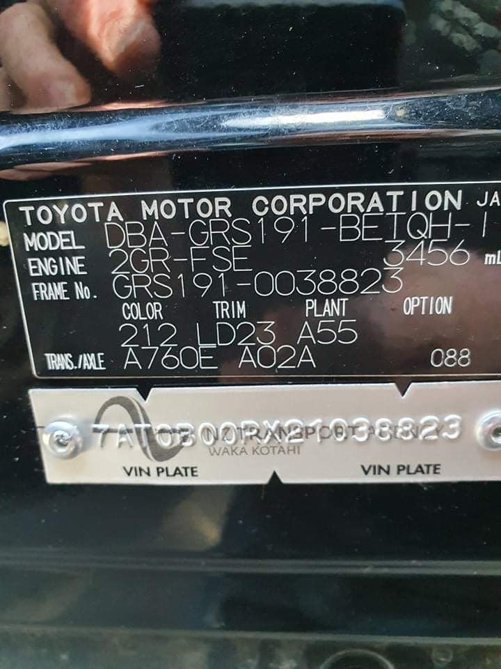

Thanks for the help all. The photo attached relates to the (allegedly) Japanese GS350 I’m looking to take the diff from. The model code seems to differ from the ones listed in this thread, which has me scratching my head.

GRS191 is the code for the GS350 RWD. GWS191 is the code for the GS450h.
What's with that vin plate O_O
I’m based in NZ, so the VIN plate is added for imported vehicles (we get a lot of Japanese imports into the country).
And now for a confession. I don’t actually have a GS450H, but rather a GWS204 Crown Hybrid - not that there are many differences mechanically it seems. Unfortunately Toyota decided to throw the 3.2 diff into the Crown hence my desire for a differential swap out.
