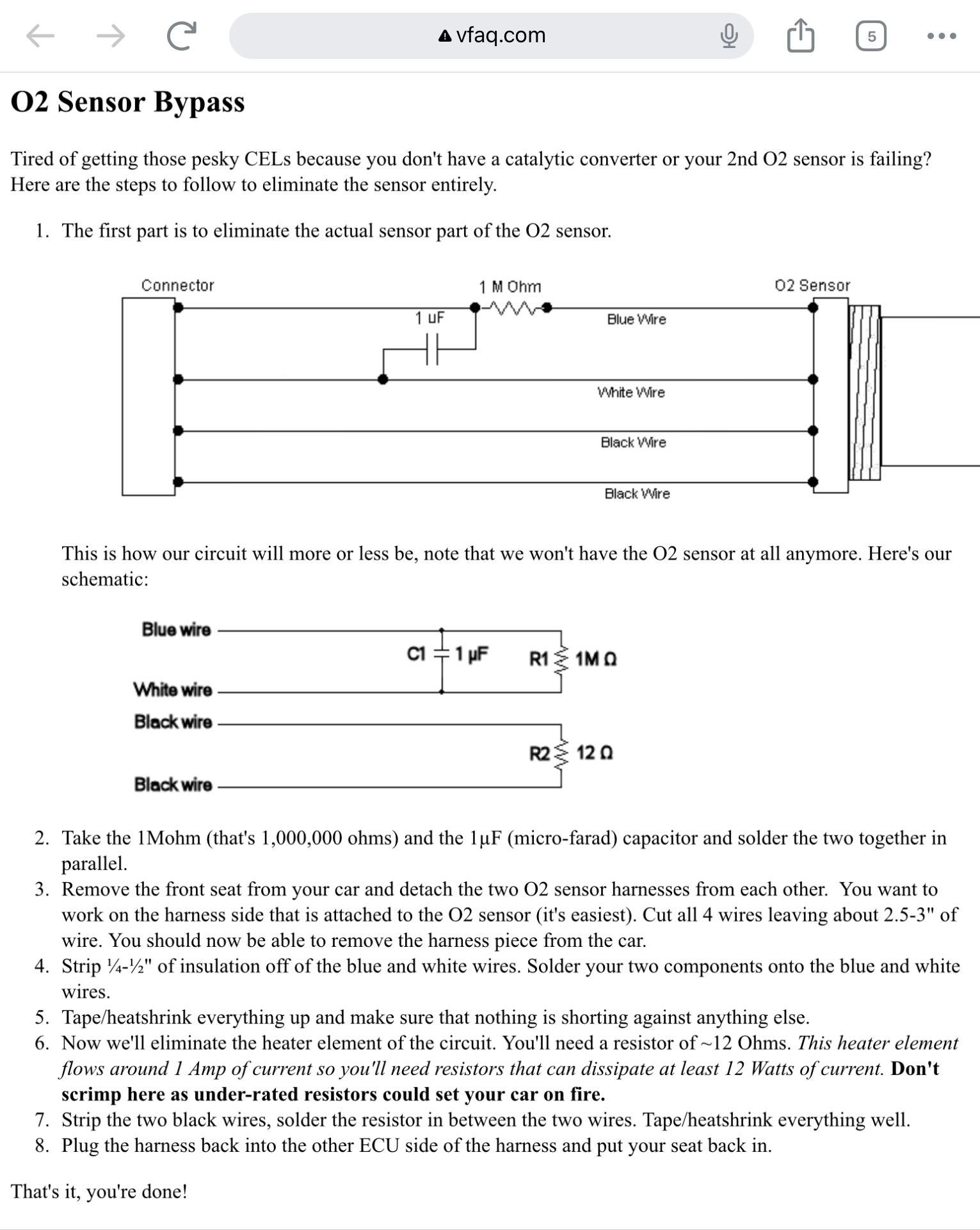

No, no help. It may or may not solve it. If you can sniff and know your cats are working, there’s a work-around for failed sensor or post-cat air leaks. Since I sniff tested it and knew the cats were workign well within limits (Toyota trips the code crazy early vs. emissions requirements), you can do this.
