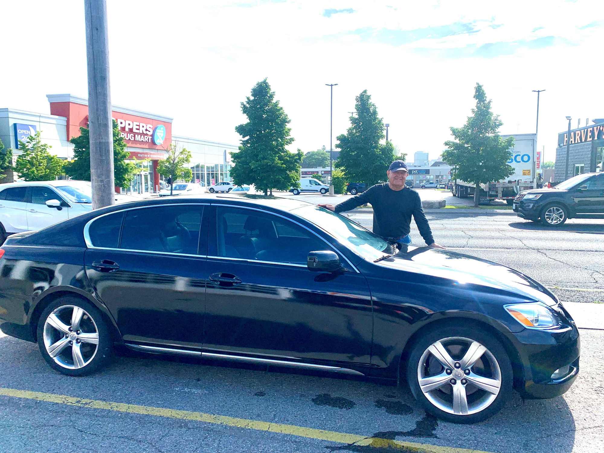

This is my GS 430-- '06 with 93,000 km. It's got a camshaft seal oil leak. What parts do I need to fix it and to replace the timing belt? Is there a kit? What's the part number? Many Thanks
