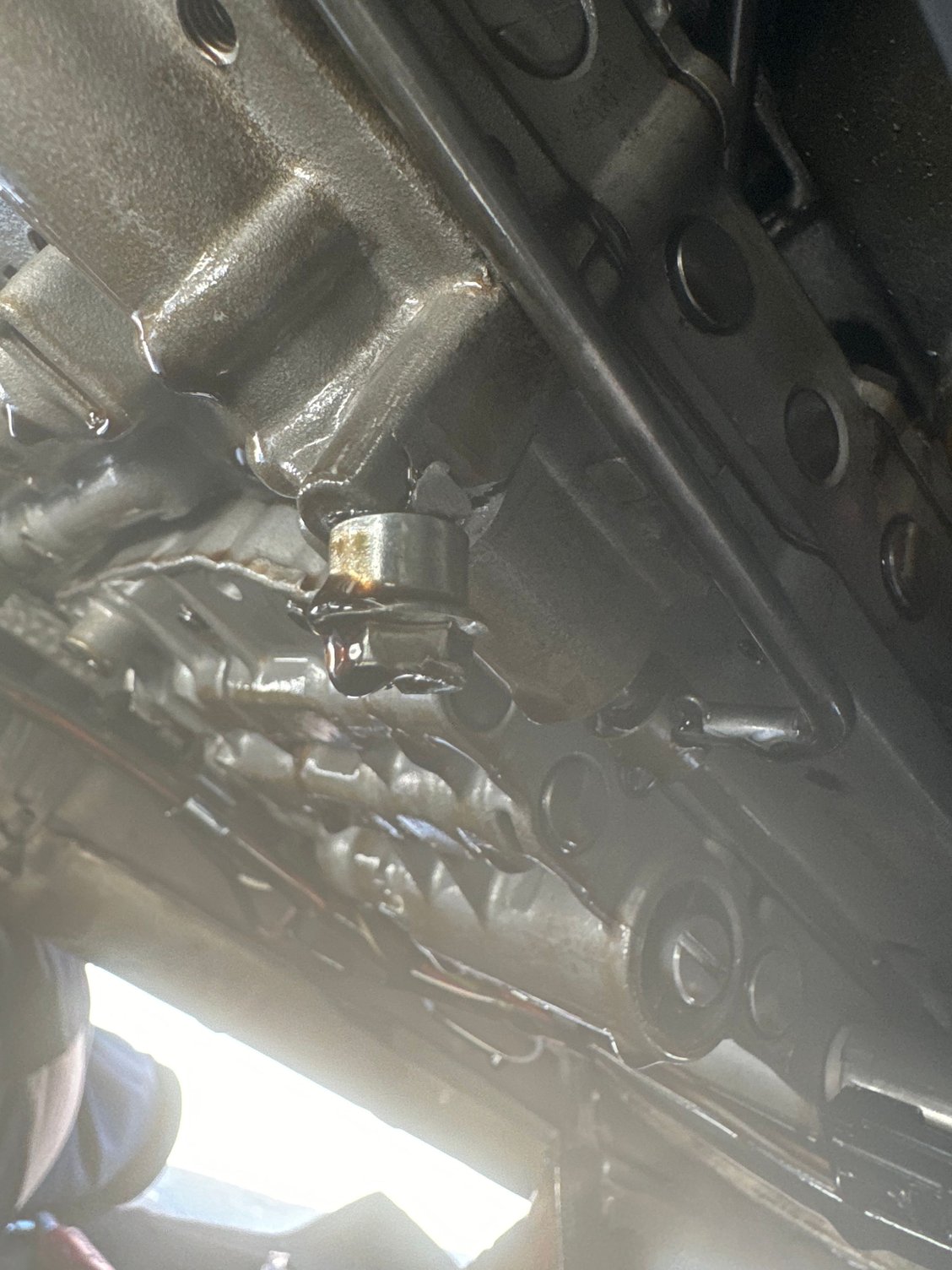

So I just got under the car and I think I found the problem. One of the pins looked stripped and the valve body has a crack in it. Could that be the reason for the solenoid code?

If the fluid travels to the solenoid and thats been comprimised then yes it would effect the performance of the solenoids. Weird how its cracked, maybe the person trying to install the solenoid broke it. Or maybe the car was into an accident that crushed the transmission pan, and the previous owner just replaced the pan.
Are you able to find used parts? Worst case buy a whole used transmission and remove the parts that you need.
