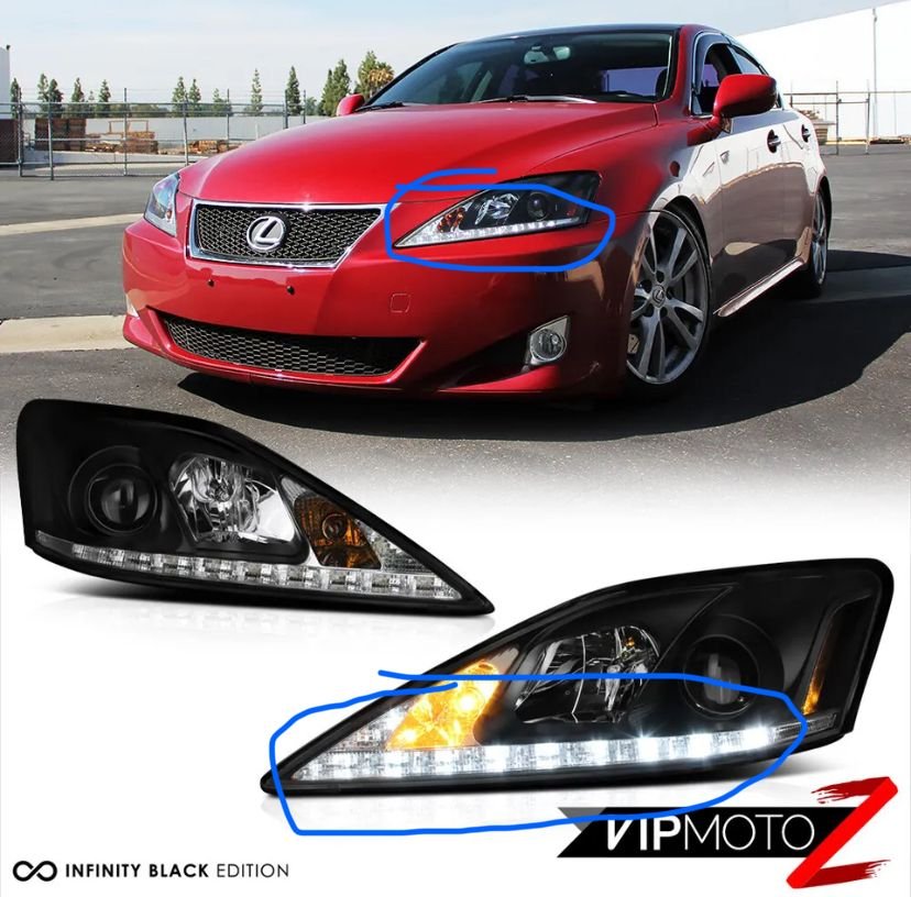

So I know that most people are referring to the highbeams that can be found on the 06 gs300 but I’m trying to find a way to disable or fix a not working light strip. Picture below.
Haven’t found anything online referring to this specific light.

You use techstream windows pc obd2 program and then disable the DRL feature function in the customize settings section in the techstream pc program.
