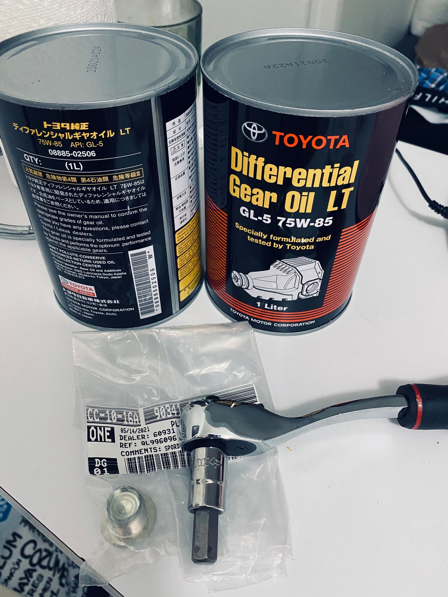

I only did my rear, but would like to add that I got my oil from the dealer, as well as new plugs, just in case. Also, always the fill plug first.
