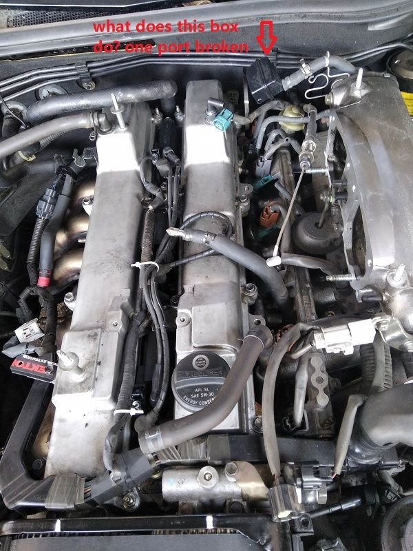

what is this part name/number? one port broken, looks like just an empty box
05 GS300, box port is 8 and 9, label PA66
any body knows related hose size? a few cracked or harded.
Thanks for help!

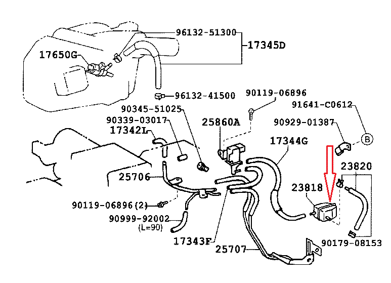

Is this the one you mentioned?
This is fuel vapor chamber for the EVAP system that goes to the engine intake.
You still can buy it 23818-46110

It is! Many thanks!

just bought this 5/16" hose hope it fit, most my hoses are hardened or cracked

eventually used 1/4 gates hose, as 5/16 is not very tight for vapor fuel line which is a black plastic box w/o clamp I also have no clamp.
