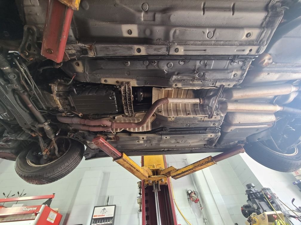

Man the previous owner welded everything and took out the rear cat, this is going to be a bigger job than I thought..
Got an API 5yr guarantee cat system brand new C.A.R.B efficient for a few hundred that going to be installed

After 3hrs the new exhaust on
Could be just me but I'm thinking the new exhaust makes the car::
Run a lot smoother
Turns on a lot quicker
Feels a lot stronger like it got more power?
No more rotten egg smell
That old exhaust really made the car run like crap based off these improvements....
Only issue now, the check engine lit was reset and came back on driving to work?
Is tis normal?
Thanks in advance

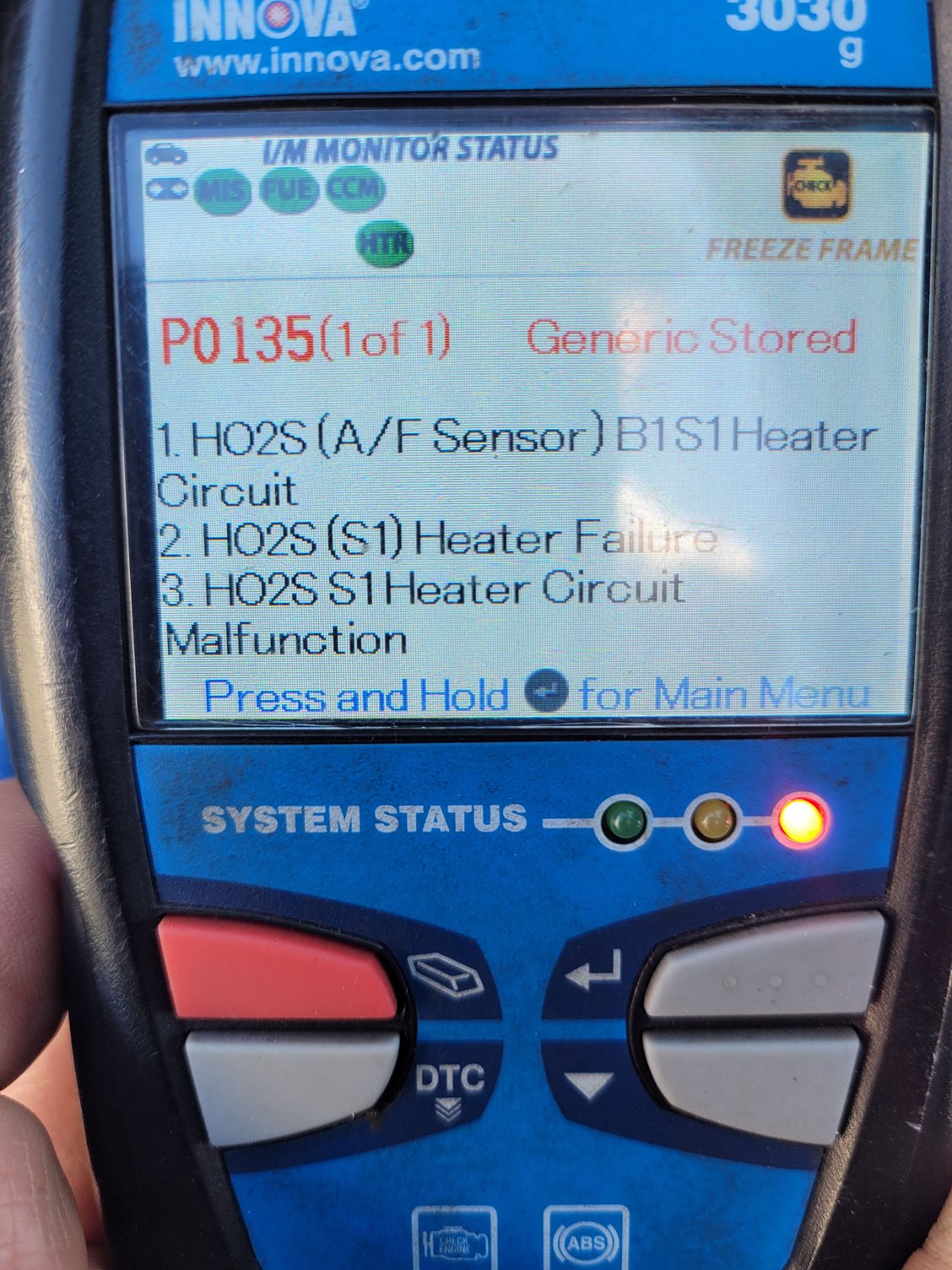

For the check engine light, use an OBD2 scanner to read which codes are actual. There may be something else unrelated to the exhaust oxygen sensors.
This is the code that came up after the new exhaust

What brand 02 sensor are yall using?
NGK. Go to rock auto.
