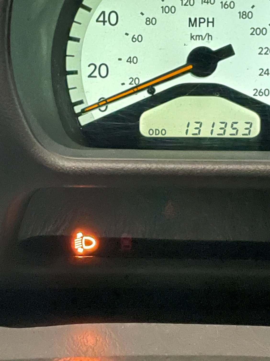

Does anyone know what this light means? Just came on my dash.

It means there's a problem with your headlight angle adjustment system.

Thanks! Went away so I guess it was just a fluke. Sounds like something that would probably cost a lot to repair or replace

If it was especially cold, its possible that the lights had "frozen" into position and thus when the system tried to adjust them, it couldn't, and then when it warmed up all was fine. That could explain the temporary nature of the warning light.

yes it was cold that’s probably what happened then. Thanks !

If it comes back check the headlight actuator and the leveler arms on both front and rear driver's side lower control arms.
