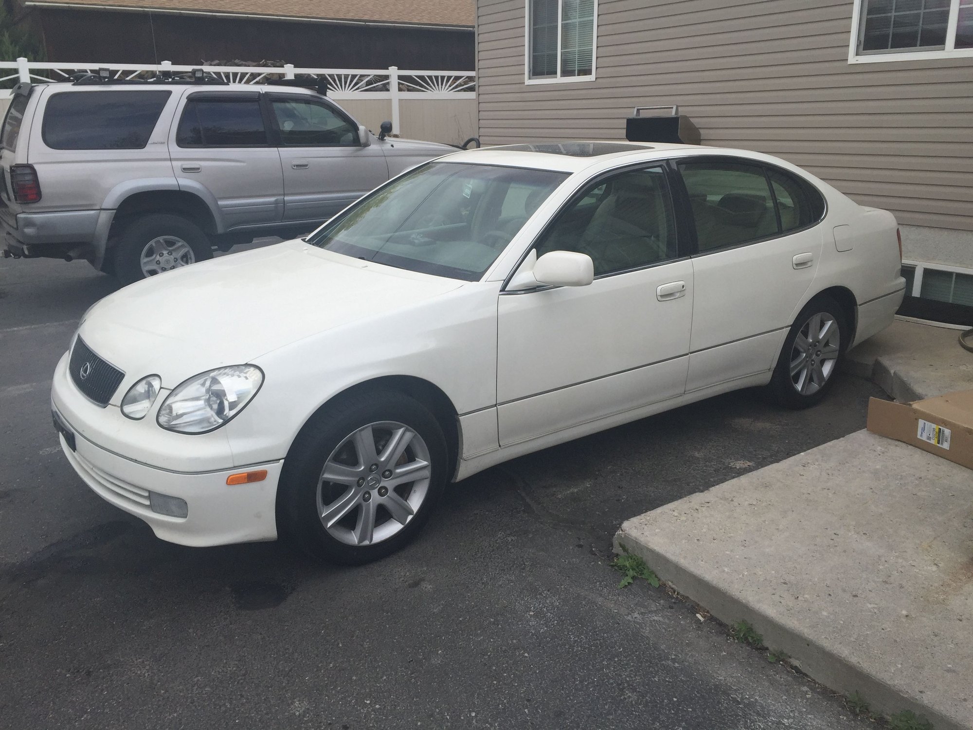

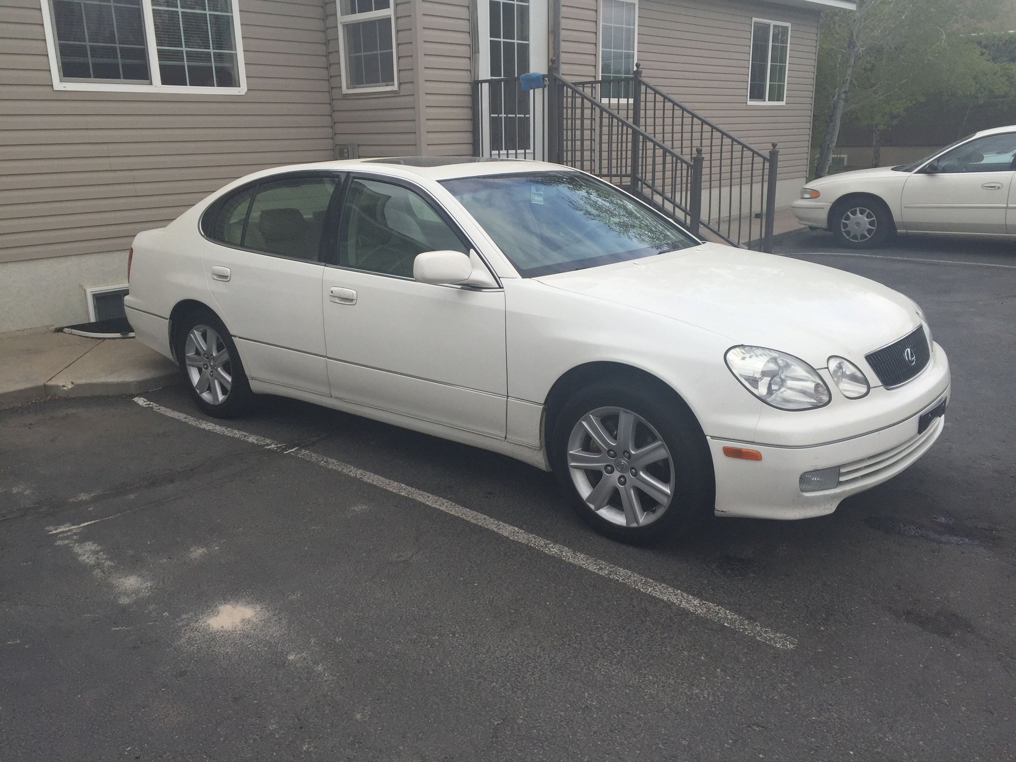

I purchased this car feb of this year. 99 gs300. Bone stock. 200k miles.
