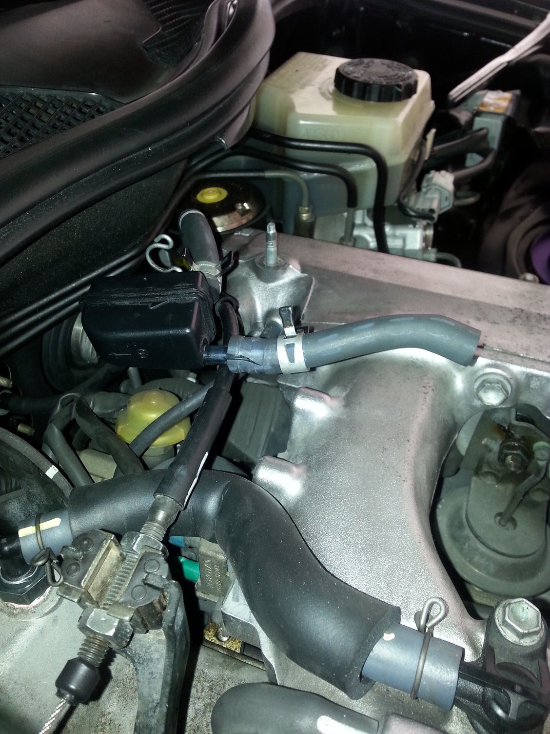

Originally Posted by k311in
U sir r a god send. Thank u. Mine was that hose totally split in half. Replaced and no more check engine light. And to think I was just about to tackle the charcoal canister for those codes. Cam on
On my car was this one.
The clamp cover the crack on the air hoses
