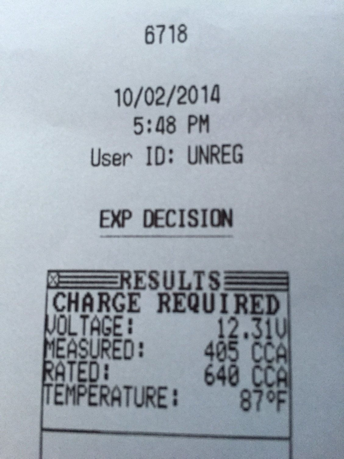

Advanced Auto battery test results
They said everything checked out fine. Which I suppose is good news but still perplexing. The tech said if you do not drive your car more than 30 minutes a week, then yes the battery dies. This happened to me in winter, but in September?

Get a DMM and check your battery. 12,31V is not a good charge. Charge your battery, measure the voltage with the Charger connected. Then take the Charger off and put the DMM on the battery to check the voltage. It should stabilize at 12,6-12,8V. Lower than that and i would change the battery due to sulfating cells. For voltage checks connect + and - of the dmm to + and - of the battery, set DMM to 20VDC. for current measurement put the dmm to Amps, remove the GND from the battery, + to the cable of the GND and - to the - battery pole. make sure you start in the highest amp mode as a low mode can harm your meter.

Usually a battery does hold its charge. As i said, measure the battery after charge and see if the voltage drops by itself. For me it sounds like a bad battery. Even if you don't drive a lot.
