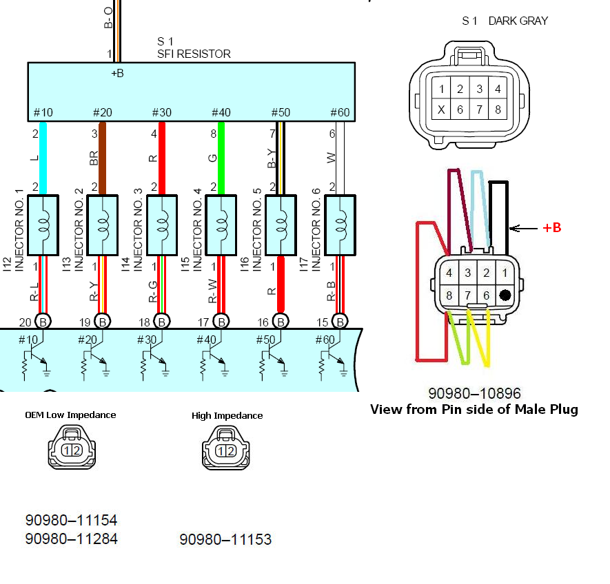

Need some help guys. I upgraded my injectors in my aristo swap from 440s to 550s. To my understanding 550s are low impedance and the aristo ecu requires high impedance. How would I properly wire them or whats the proper procedure? I checked the forums and couldnt find anything on it.

You just need add the resistor box from a us supra..

Great!!! Thanks for the help bro!!!
