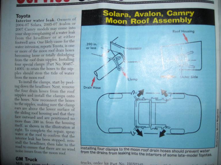

5.Moonroof Drain Clogged
+ Fill a cup of water and place it in the Moonroom Drain
+ It should flow out underneath behind the front tire.
+ Check if it is leaking in the car.
+ If it is use compressed air to blow the debri out of the drain.
+ Video: http://www.youtube.com/watch?v=5-JE2Isu0qs
Clogged moonroof drain seems to be the likely culprit. This is a common problem on Toyota vehicles. Last months 'Motor' magazine has an article with diagrams about this very problem and how to remedy it. I will see if I can get a snap shot of the article and post it up.

Hope this helps.... Good luck.
